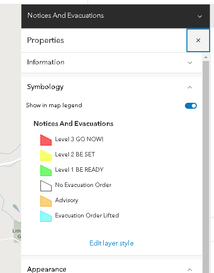

I am trying to figure out why my layer is not changing its symbology when I am trying to edit in AGOL map viewer. This is a layer created by the Emergency Management Operations Solution . I needed to customize the Notices and Evacuations layer for my organization. I need the Symbology to match and show my customized choices.Here is the Symbology for the layer
Here is the symbology when editing.
