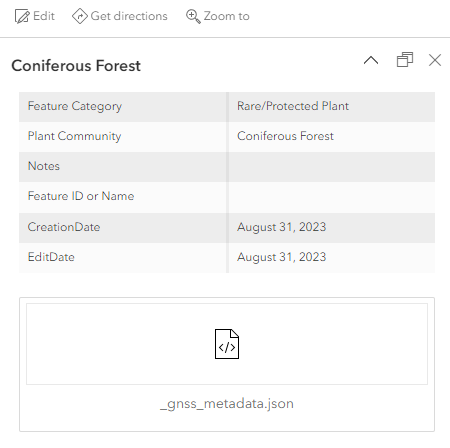

Is it possible to hide the _gnss_metadata.json attachment in the "new" Map Viewer without disabling attachments in popups entirely? It just confuses users and adds unnecessary clutter. This was never an issue in the Classic Map Viewer.

Thanks for the suggestion, Clay. The method you referenced looks like it only works on layers shared publicly. I can't make this one public, unfortunately. I'm going to look into this option a bit further.
In this particular case, I'm seeing the GNSS metadata attachment on a polygon I created on my iPhone (no external GNSS unit or anything). However, I've seen it before on features created with Trimble R1 and Catalyst units.
Edit: the polygon was created in Field Maps and the layer has GNSS fields enabled.
@ClaO When you collect line or polygon features with the GPS / GNSS metadata fields present in Field Maps, a JSON attachment is used as part of the process. That is not the case for point features.
There is note relating to this in Prepare for high-accuracy data collection, "To capture GPS metadata for line and polygon features, attachments must be enabled for the feature layer."
@jmaxwell_braun If the GPS / GNSS metadata fields are present, then when you collect a line or polygon -- even with your iPhone's internal receiver -- a JSON attachment gets created. The presence of the fields seems to be the dependency, rather than what receiver is used.

Yes this is a dumb error in the popups. I found an imperfect workaround: In the Layer Properties, then Popup configuration, then Attachments: you can set the order of attachments to display by "Size" then "descending" order. This will at least show the photo attachments at the top of the viewer and bump the stupid _gnss_metadata further down so it's not in your way as much.
Great tip @andrewRaaf! Not a perfect workaround, however, it does improve the user experience.
