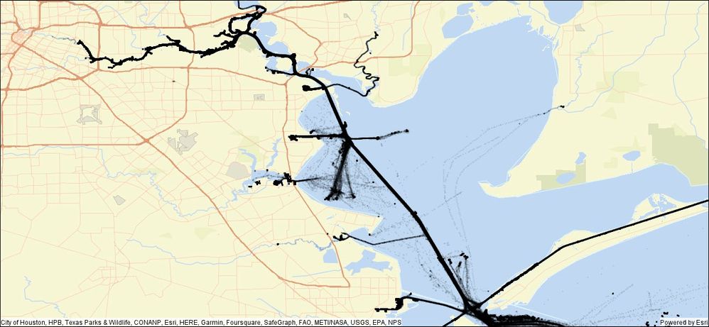

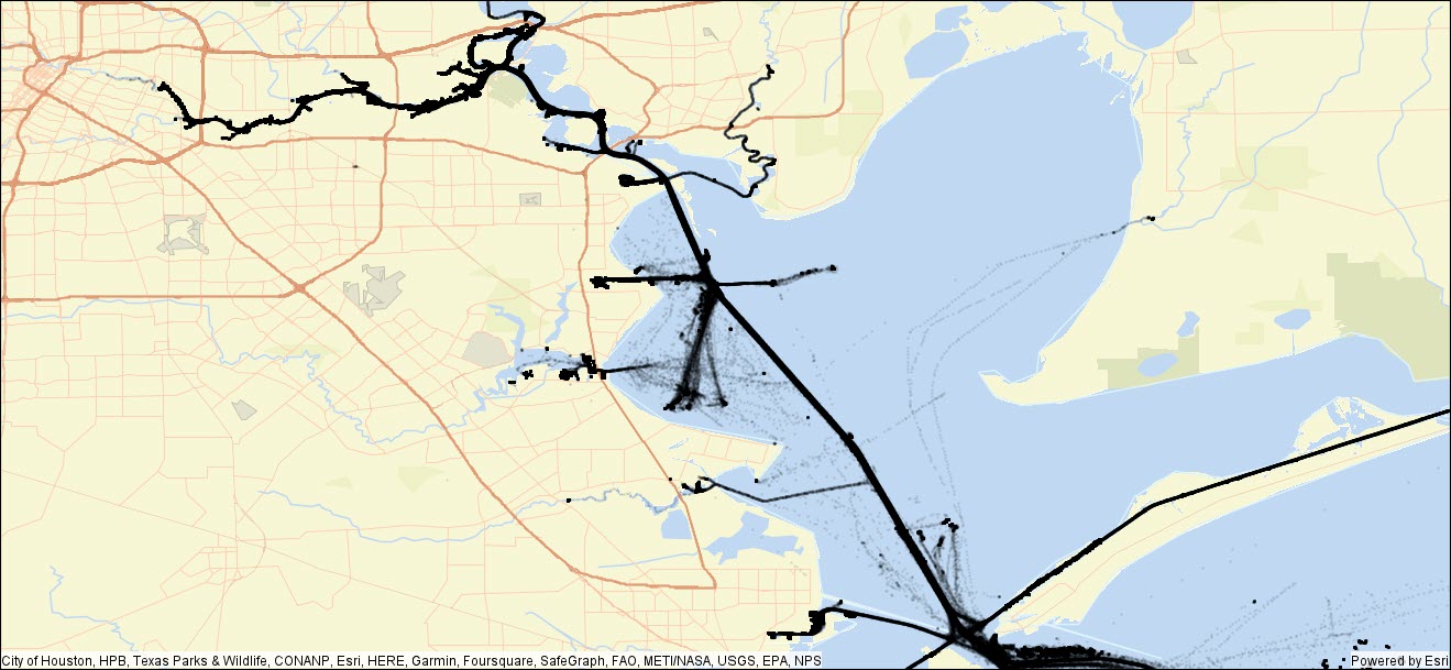

At this point in time, we will have a dataset that is ~1.2 million records. We can see the shipping lanes taking shape visually – but at this point it’s just a lot of individual points coalescing to form visual lines.

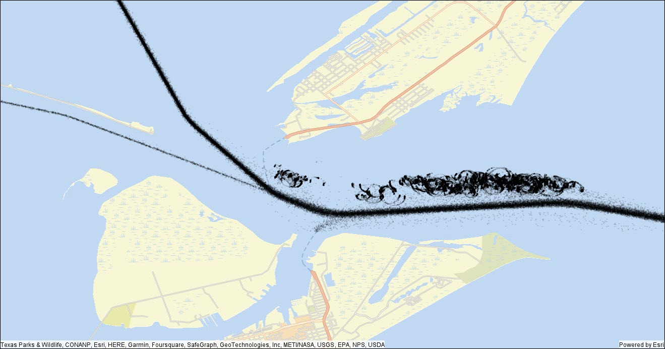

When we zoom in, we can see that it’s still a messy dataset with a lot of variation and noise in the paths.

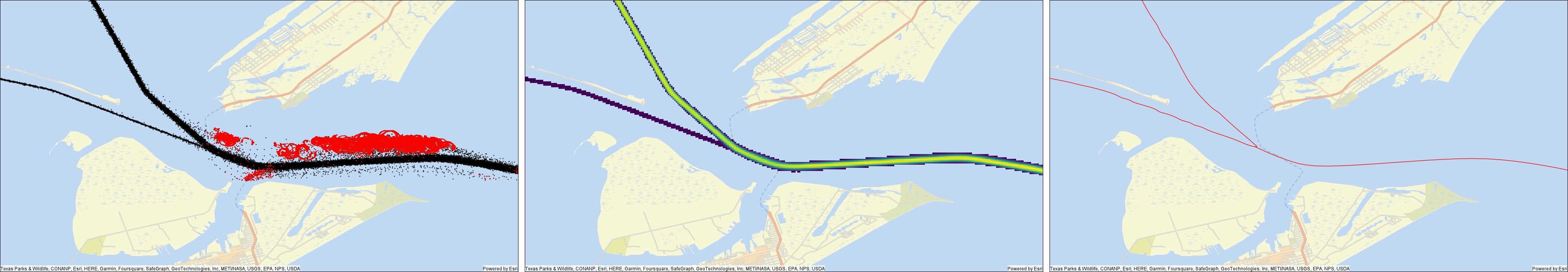

Remove Dwells

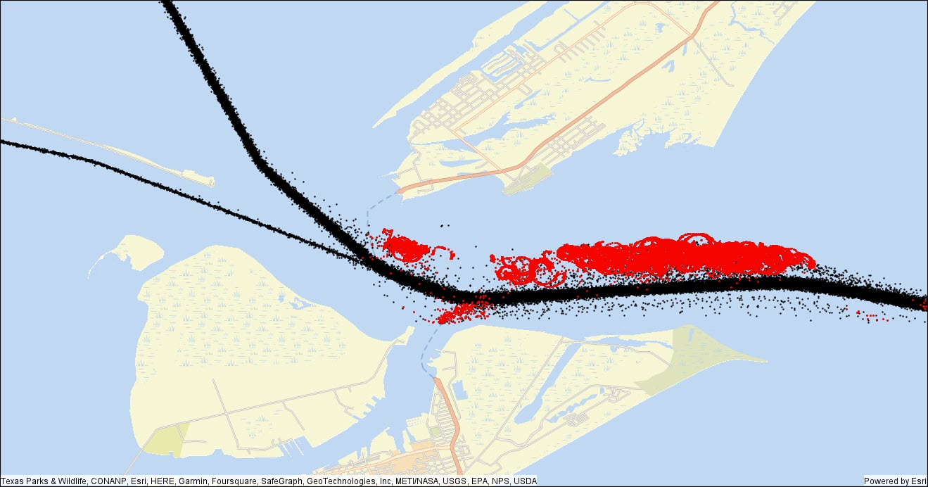

In the detailed image above, we can see a particularly large amount of noise north of the area that looks like the main shipping lane. This is likely where vessels have anchored for periods of time. We don’t want that noise to skew our centerline calculations, so we can use the Find Dwell Locations tool to identify the points and remove them from our analyses.
In this case, we are defining a “dwell” as when a vessel hasn’t moved more than 500 meters within 120 minutes.
# find dwells
from geoanalytics.tools import FindDwellLocations
result = FindDwellLocations() \
.setTrackFields("MMSI") \
.setDistanceMethod(distance_method="Planar") \
.setDwellMaxDistance(max_distance=500, max_distance_unit="Meters") \
.setDwellMinDuration(min_duration=120, min_duration_unit="Minutes") \
.setOutputType(output_type="Allpoints") \
.run(dataframe=observations)
The dwell locations are identified in red below – and they seem to nicely match with the areas just off the main shipping route where the ships would reasonably anchor while waiting.

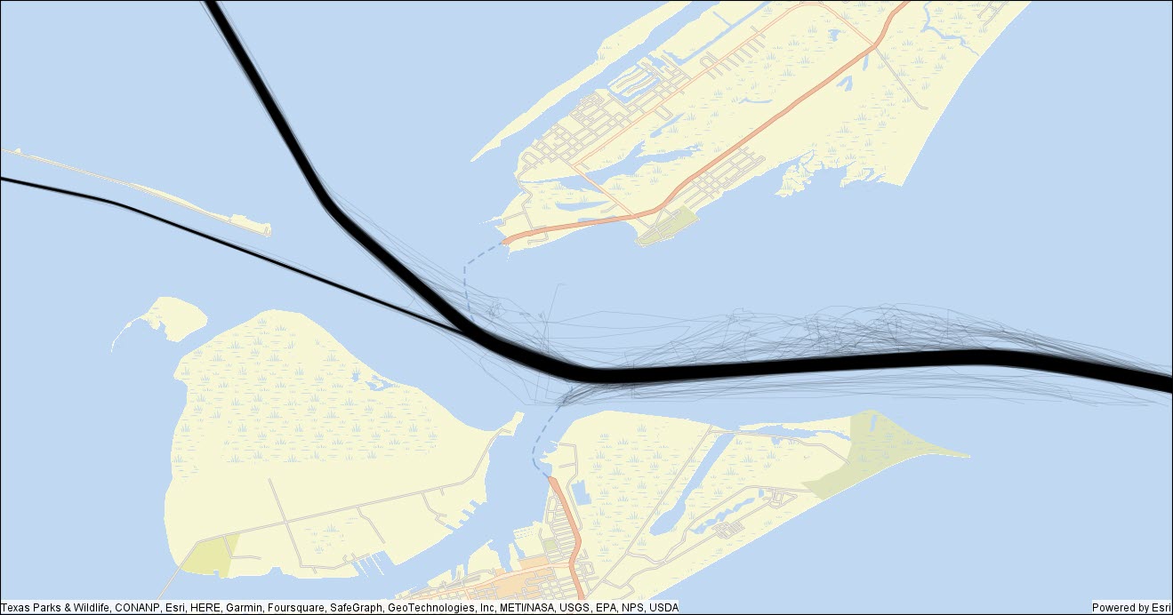

Convert AIS data into tracks for each vessel
Now that the Dwell points have been identified, we can easily select out the remaining points to convert into tracks for each vessel. To do this, we use the Reconstruct Tracks tool to connect the GPS points for each individual vessel (identified by the MMSI attribute) and limit the points used to only those where the DwellID is Null. This results in 1,172 unique vessel tracks.
From geoanalytics.tools import ReconstructTracks
tracks = ReconstructTracks()\
.setTrackFields("MMSI")\
.setDistanceMethod("Planar")\
.setDistanceSplit(1, "kilometer")\
.run(observations_dwell.where("DwellID is Null"))\
.localCheckpoint()

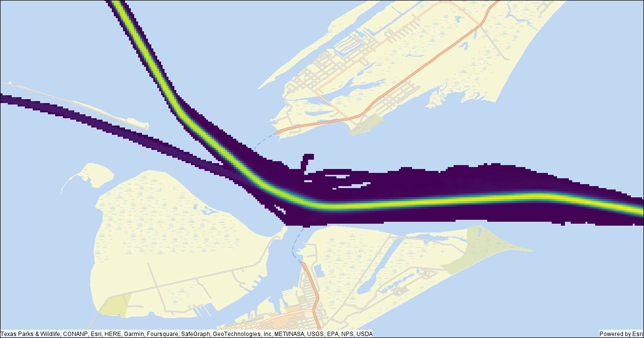

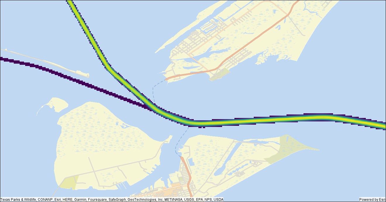

While we could visually pick out the overall pathway most traveled by the vessels because the lines for their tracks coalesced together into a single thick black line on the map, we don’t have a sense of where in that thick line the traffic is the heaviest. We can identify that by spatially binning the data and counting the number of paths crossing each bin. In this case, we’ll use a set of 50-meter square bins to find the areas with the greatest traffic.
bin_size = 50 # meters
bin_buffer = 50 # meters
bins = tracks.withColumn("bin", F.explode(ST.square_bins("track_geometry", bin_size, bin_buffer)))\
.groupBy("bin").count()\
.withColumn("bin_geometry", ST.bin_geometry("bin"))\
.localCheckpoint()
That gives us a nice set of data showing frequency of vessel traffic.
Now, we can clearly see the most traversed lane in the middle, but there is a lot of noise surrounding it – likely due to the ships traveling to or leaving anchor points or veering slightly off the main path. We can easily remove that by filtering down to just the bins with more than, say, 50 vessels traveling through that location. While this threshold is appropriate for this data, if you are working with much larger datasets your filter value will likely be higher.
Filtering to just the bins with more than 50 vessels traveling through gives us a cleaner view:

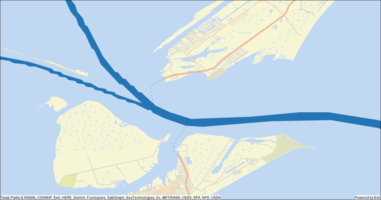

But these are just square bins, how do we turn them into a shipping lane?
Union and generalize the bins to create travel regions
To convert the bins into a polygon showing the most traveled region we simply union them together to create a big polygon. Then to make it less ‘blocky’, we’ll generalize to smooth out the edges.
unioned = bins.where("count > 50")\
.groupBy().agg(ST.aggr_union("bin_geometry").alias("unioned"))\
.withColumn("unioned", ST.generalize("unioned", 50))\
.localCheckpoint()

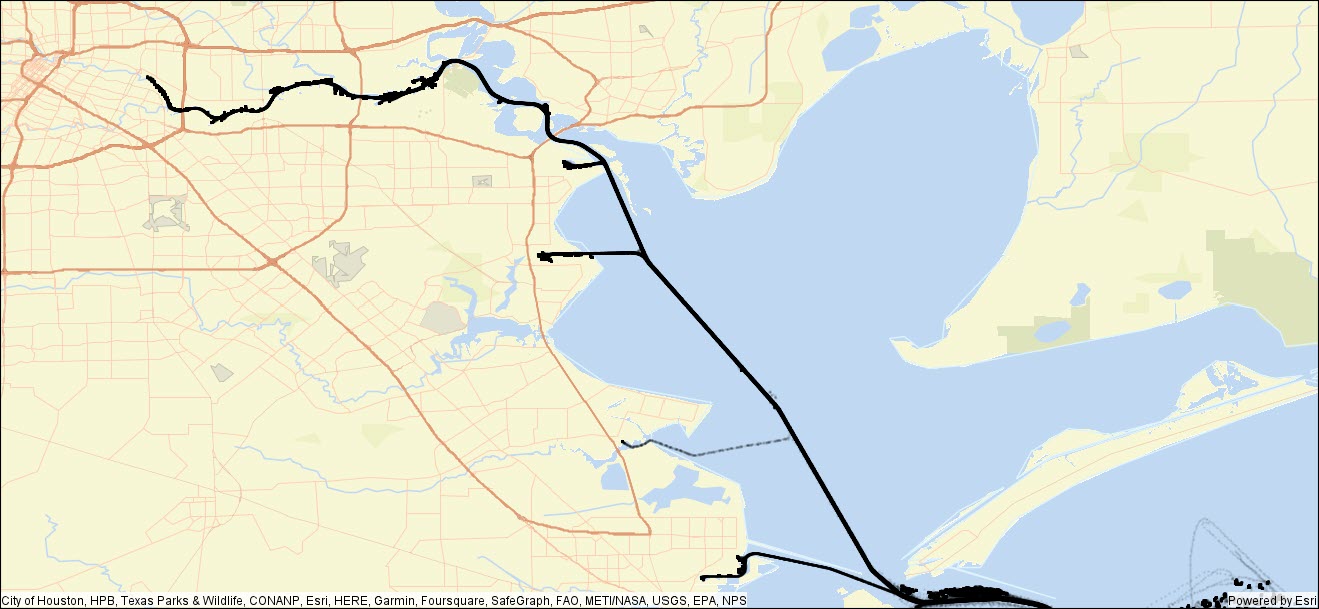

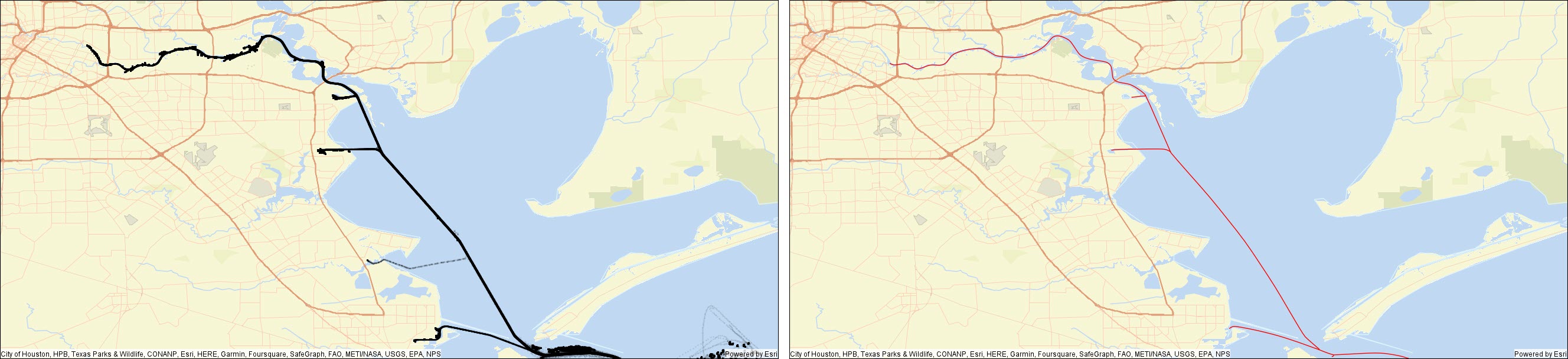

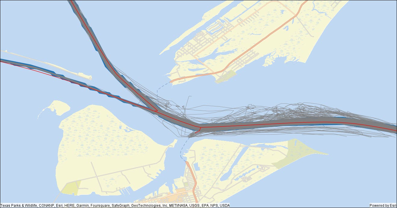

That leaves us with a nice single polyline representation of the common pathways!
Here is the final result for the whole Galveston Bay region, from raw GPS data points to streamlined shipping lane polylines!

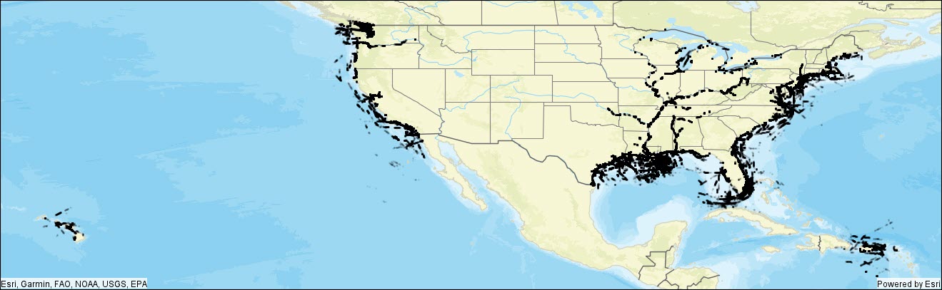

For the entire dataset (~52 million records when reduced to cargo and tanker vessels), it took 4 minutes and 4 seconds in this local spark cluster. Using a larger bin size of 300 meters – more appropriate for small-scale mapping (large geographic area), instead of the 50-meter bins used for the Galveston Harbor subset, reduces the processing time to about 90 seconds. Even better performance can be achieved by transitioning this workflow to a larger cloud computing cluster that is optimized for data processing at scale. With a more performant computing cluster, this workflow can easily scale up to work with hundreds of millions, or billions, of data points!
