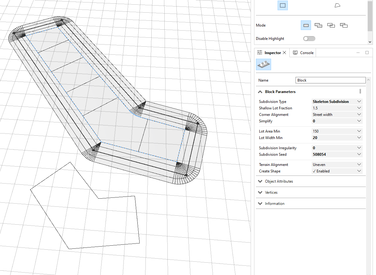

Overall - it would be useful to have the precise control of the Split and SplitByArea functions in CGA, but with more geometric flexibility. Skeleton subdivision can wrap around corners (great), but I can't set a precise width for it (only a minimum). This makes it difficult to place connected houses in the straight areas of the Lot that have a given width (e.g the top left of the image below).
