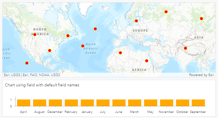

Let's look at an example. Here data is collected that includes the month in which something occurred. A survey was created with the months as the options and the results were put into a dashboard. In the chart, they order alphabetically. In the following dashboard, I've filled out the survey 12 times, putting 12 points on the map, one for each month. Notice that the chart has the months alphabetized:
You can adjust this sort in the dashboard, but only to choose reverse alphabetical order.

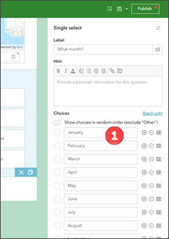

- Add your choice question, either Single select, Single select grid, or Dropdown. Provide the choices, using the words that the person filling out the survey expects (for example, January, February, March, etc.).

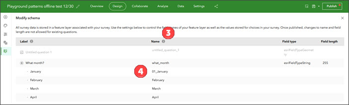

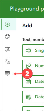

- Click Modify schema.
Note: You can only do this before the question is published. After that, you can't rename the choices. After a question is published, you'd need to delete the question and re-add it to rename the choices. And if you already have collected data, it won't use the new question or naming.
- In the Name column, click the value you need to change (for example, January or February).
- Pre-pend the word with a number.

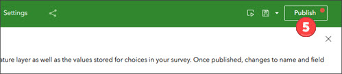

A best practice is to use "01_" for the first, "02_" for the second, and so on. The 0 lets you have more than 9 ordered choices. Although you've added numbers, they'd sort 1, 10, 11, 12, 2 (using the first digit and then the second when sorting, the same way alphabetizing is done). - Once all your values are updated, click Publish.

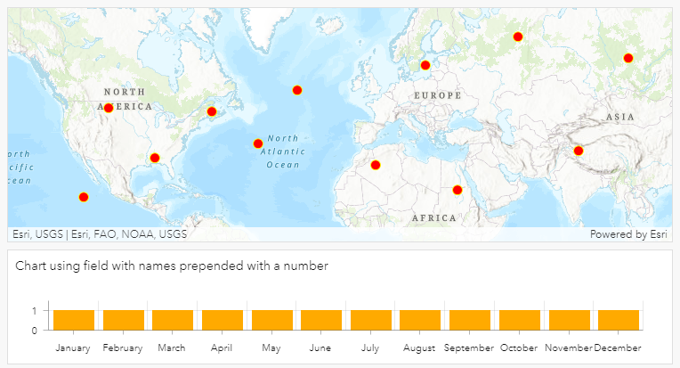

- Now when you use your data in a dashboard, the choices will sort according to the numbers you put before them.
Happily sorted dashboard charts!
Now when you put your data into a dashboard, the charts will sort how you'd like.
