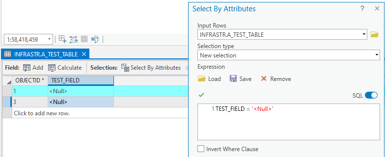

In the attribute table:
The value in the first row for TEST_FIELD equals '<Null>'. The value in the second row is a true null.
We can't tell from looking at the attribute table that the two values are different. The only way determine if a value is one or the other is to query it using Select By Attributes, etc.
Idea: It would be very helpful if we could visually discern the difference between null and '<Null>' right in the attribute table.

Sounds like conditional formatting that you get in Excel? I think if it was limited to just colouring up Nulls that would be OK but colouring up other values feels like overkill. Good idea though.
@DuncanHornby For true nulls, the text could be italicized, a lighter grey color, or something like that.
QGIS handles the same situation by having actual NULL italicized and light-grey.
Thanks for the Idea, @Bud. We think this is an Idea worth considering and one of our teams is taking a look at it in more detail. I've relabeled this with the editing label for better placement and moved it to Under Consideration.Thanks for all your efforts on the Ideas Exchanges.
