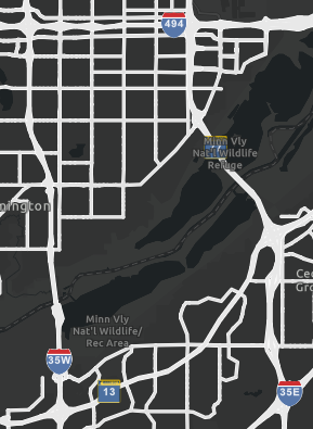

Everything validates correctly in pro and functions properly there. If published as vector tiles though, the roads for this scale/display filter just don't work. (Left query with comments, right query without comments)
