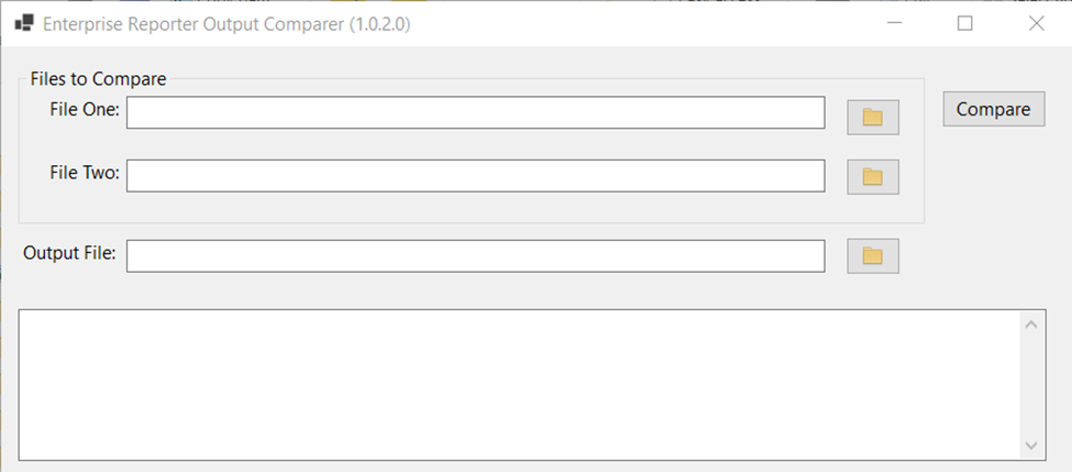

The application can be run by double-clicking on the er_compare.exe executable. When run in this way, you may briefly see a command window appear. It will be replaced with a graphical user interface as shown here.
Navigate to the two output files that you wish to compare from the two systems; those will be your “File One” and “File Two”. You can compare the “admin” outputs of two systems to see how the administrative configurations and services inventories compare. Or, you can compare the “content” outputs of two systems to see the differences/similarities between the Portal content.
“File One” is typically the “source” system, the one that you consider to be the standard against which you want to measure the other system. For example, if you have a primary data center and a stand-by data center, the primary data center would be “File One”. Or, if you have a Production system and a Pre-Production system, Production would be “File One”.
The application will suggest an output file location and name based on your inputs. But, you may name it and place it wherever you like. Then, click the “Compare” button.
The tool will report its progress in the lower status pane of the application. When it is complete, it will change the “Compare” button into a “Dismiss” button.
Note that you can also run the tool on the command-line. If you do so, provide three space-delimited arguments for “File One”, “File Two”, and “Output File” and the application will do the same thing as it does from the graphical user interface.

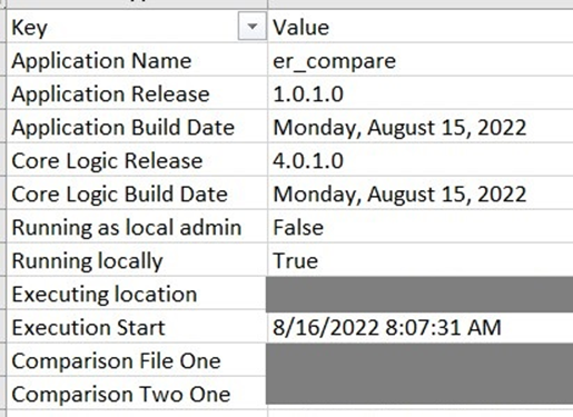

The first sheet is always “Comparison_Metadata”. It has the structure show below:

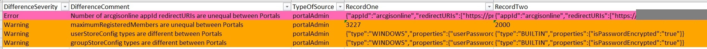

The remaining sheets will be named for the input sheets that they compare. For example, “portalAdmin” compares the Admin API sheet from each Portal. An example of a comparison output for it appears here

The portalAdmin example above shows that the tool has identified one “Error” and three “Warnings” (the rows in all sheets are color-coded by these classifications).
The Error shown here is that there are a different number of “redirectURI’s” for the “arcgisonline appId”. These appId’s are used as part of the ArcGIS Enterprise OAuth security implementation. Note that the application is not comparing the values. The values across two systems can be different. Instead, it is comparing the number of redirectURI’s. It does not know how many there should be. But, it assumes that the “source system” (“File One”) has been configured according to your intent and the other system should be a numerical match for the number of redirectURI’s.
The first Warning is reporting on a difference in the number of licensed members between the two systems. The second system may or may not have “enough” licensed members; that is for you to decide. All this tool can do is note that there are different numbers.
The second and third Warnings are noting that the source system is configured for Windows users whereas the second system is configured for “Built-In” users.
These are just examples. The tool does not report on any comparisons for which it does not find a difference of concern. In other words, in perfectly matched systems, the comparison sheets will be empty.

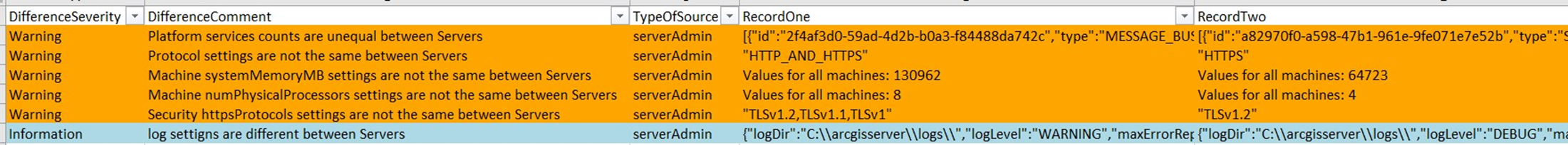

The screen capture below shows another example; a comparison of the Server Admin API for matching federated Server Sites between the two ArcGIS Enterprise systems.
The first Warning is that the number of platform services between the two ArcGIS Server Sites is different. It is not easy to see what the difference is in the “RecordOne” and “RecordTwo” cells. But, if you were to study the JSON there carefully, you would see that the “source” system has a “Message Bus” platform service, in addition to a “Synchronization” and a “Compute Platform”. The other system has only “Synchronization” and “Compute Platform”. Likely, this indicates some difference in what has been installed or licensed for this Site between the compared systems.
The second Warning is that the “source” system supports HTTP_and_HTTPS whereas the other system supports only HTTPS. This might be because the “source” system was upgraded from a prior release whereas the other system was a fresh installation. Or, it might be an indication that the “source” system has the preferred configuration and the other one should be matched to it.
The third and fourth Warnings aggregate the member and processor resources across all of the machines in the Sites and report differences. Again, these differences may be intentional or not, the application cannot know. But, a common source of problems is an inadvertent difference in machine resources. Note that the tool sums the memory and cpu from all of the machines in the Site. So, if you have different numbers of machines, these aggregates will have different values even if the per-machine resources are identical.
In the final row, there is an example of an “Information” difference. The log settings (the “logLevel”) are different between the two systems. This should not cause a problem for most use cases. But, it may be relevant to know.

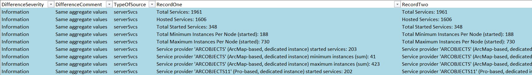

The final example here shows the “Information” comparisons of the service “analytics”.
In this case, the application is reporting that the numbers of services of various kinds, their instancing, etc. is a match between the compared systems.

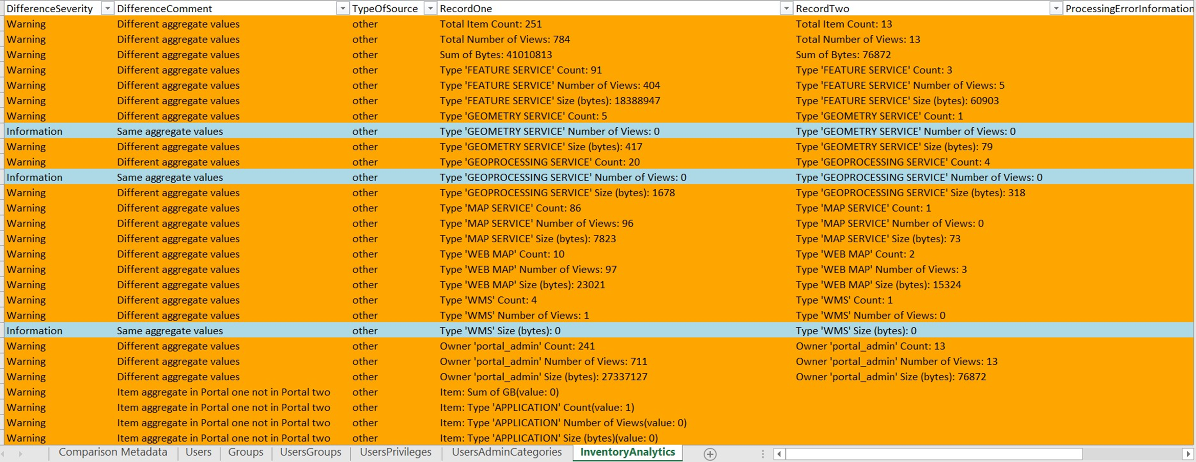

The sheets in the “content” comparison output are likely easier to understand. Below is an example which shows the sheets you can expect and an example of one of the sheets.
As you might expect, the “Users” sheet will report on any users in “File One” that are not in “File Two” … and vice verse. The same is true for “Groups” and the other sheets.
The InventoryAnalytics detail shown here is comparing the aggregate counts and sums of the content in each system. In the case of Production and Pre-Production environments, this can be useful to get a sense of “how different” the content is. And, in the case of a Disaster Recovery content synchronization, this can be useful to confirm that all of the content is the same between the two systems after the synchronization.
