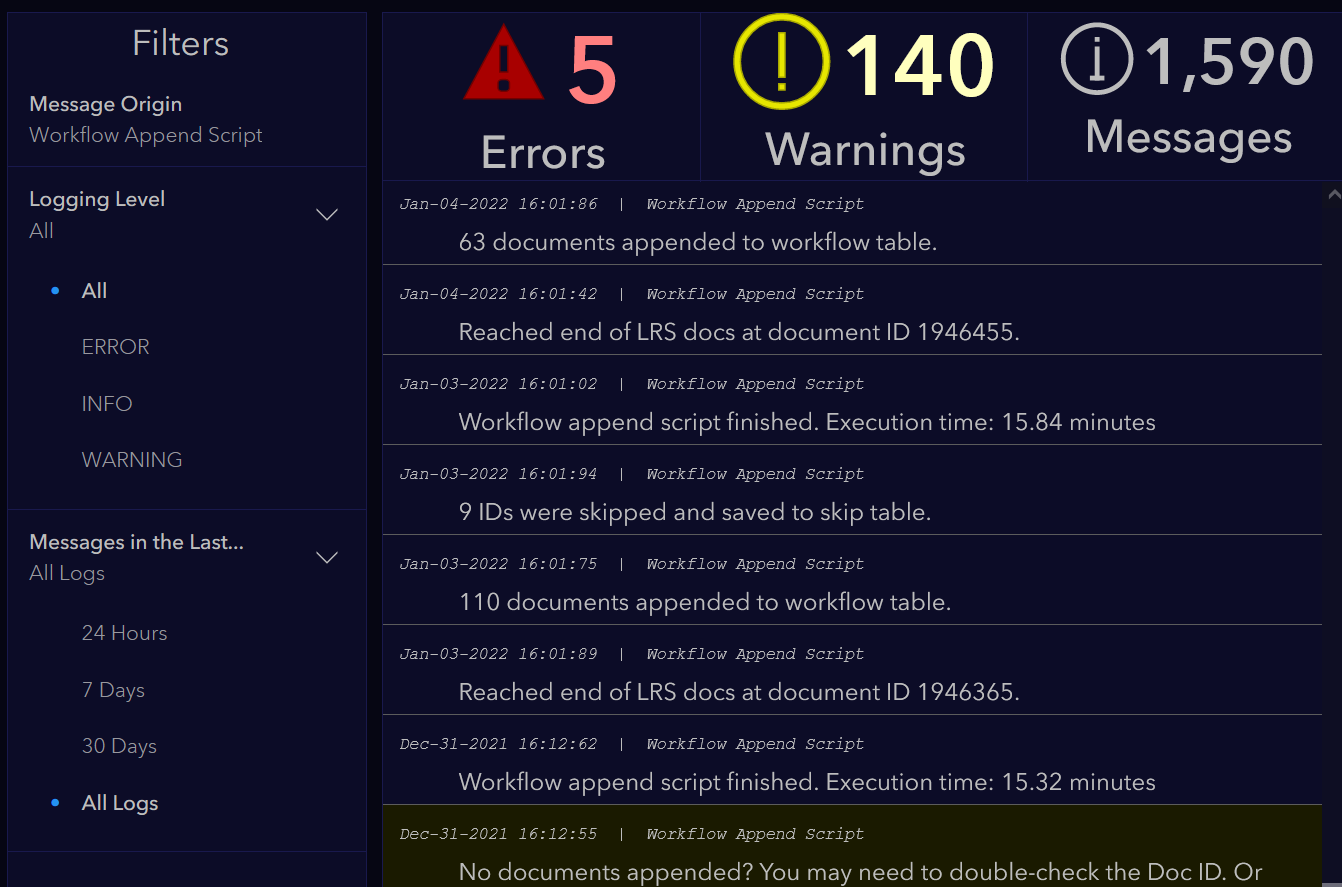

I have an admin-only dashboard that shows me recent logs generated by my scripts. I can use Dashboard's tools to quickly filter the dashboard by message origin, log level, and predefined time ranges. I use features like Advanced Formatting in my List and Conditional Formatting in my indicators to give me a quick, at-a-glance overview of what's going on with my scheduled Python scripts, all in a dashboard simple enough to easily embed elsewhere.

The dashboard portion of this is pretty simple. You could probably figure it all out from the screenshot above. Just connect to your log layer in a new dashboard and create a List. I'm on Enterprise, so I don't get those fancy Table widgets yet, but you AGOL users, go for it!

}Once you have your list, then you just need some filters so that you can quickly zero in on the logs you want. That's pretty standard Dashboard work, so I won't bother elaborating on it here.
And that's it! Now you've got one central location for all your script logs, and you can access it from any device!

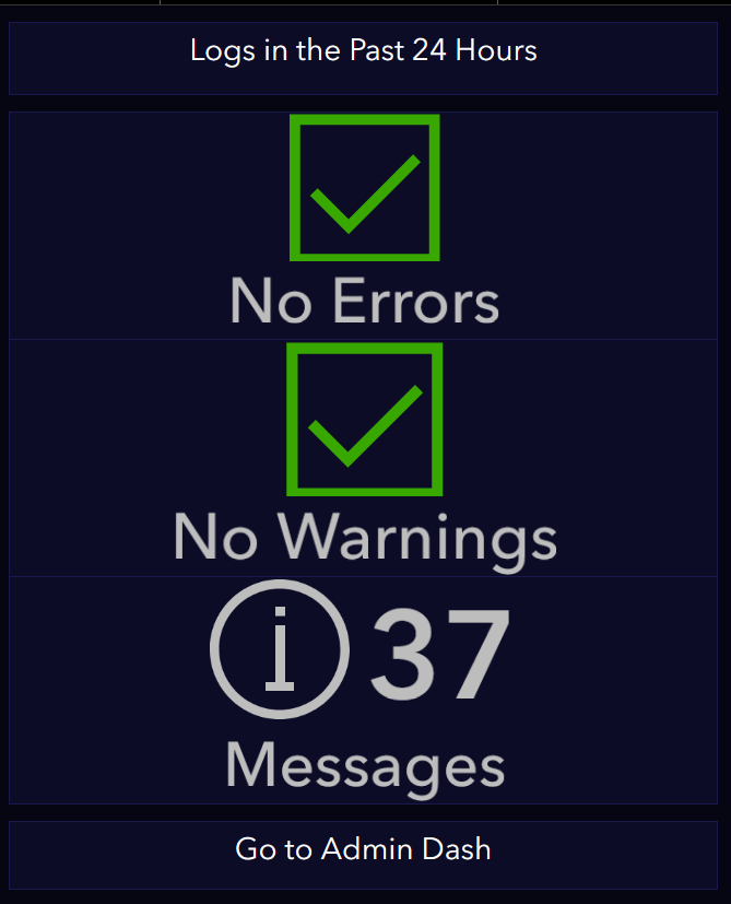

If you want to take things a step further, you can make a mini-version of the dashboard for viewing on mobile, or for embedding elsewhere.
Include a handy link to the full dashboard, and you can get into the logs if you see anything pop up that needs attention.
