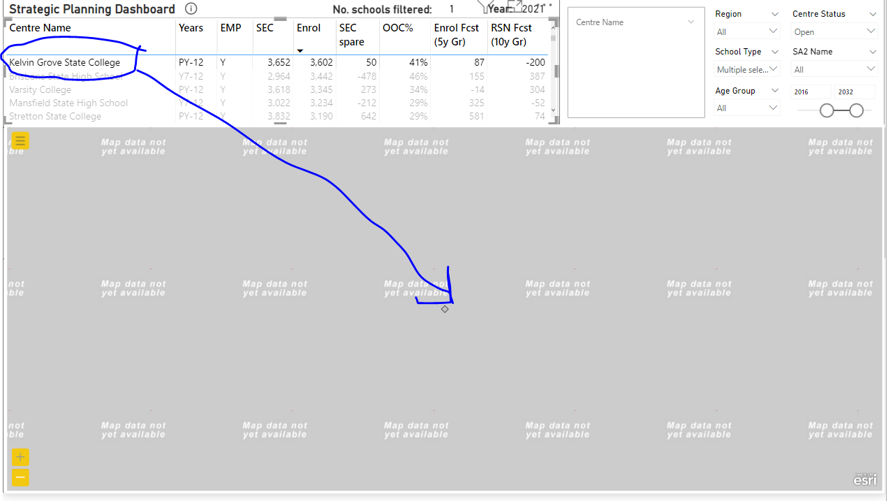

When filtering a single data point (Long, Lats) in Power bi, the Esri extension map zooms to close for the base maps to show. I would like to be able set the minimum automatic zoom limit as I am working at 1:2000 level.
I believe a number of users would be facing this same problem and would like to set the minimum and max level and let the automatic zoom do its thing.

The only way I have found to fix the issue of zooming too close is to duplicate the points and offset the Long Lats so there are more then one point to zoom to. I then make the duplicate points transparent so you dont see them on the map.
