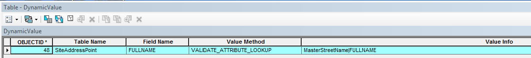

When adding a new address point feature the Validate_Attribute_Lookup method provides validation of the entered street name against the MasterStreetName table, (which is just a table, no spatial reference):
The address point feature has the ADDRNUM (house number) field and I would like to verify it to be sure it falls between the LOWRANGE value and the HIGHRANGE fields in the MasterStreetName table. Not unlike verifying with a range type domain. Is this possible with AA?
