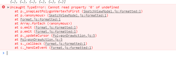

We are having issues when using the Editor widget on some of our Feature Layers. It happens when we try and add a new polygon. It then crashes the widget and throws an error, so we're unable to add any features at all.
The error we're getting is the following
it was working ok in 4.18
edit: it seems it's affecting only layers that have Z values enabled. if that helps
