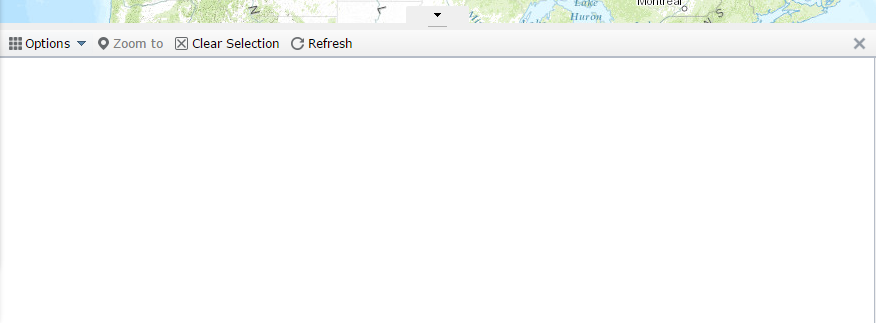

I am trying to create a div (attribute table) that would expand from the bottom and collapse just like in WebAppBuilder. My problem is that my div is hiding behind the map. Any ideas how I can get it to push the map up without loosing the current extent.
Web app Builder (what Id like to achieve)
