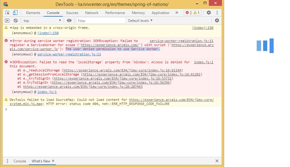

How can I fix the issue of embeding a page created with Experience Builder into external webstie. On the external website I have created an iframe with a link to the experience builder page. It works fine in many browsers. But some users returned to me addressing the troubles - the page is just loading all the time without success. The same happens in Chrome Incognito mode - . The error in the console read as follows. The Experience page is made public.
Could you please advise what might be the reason?
