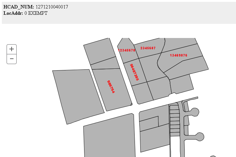

Please forgive me for what is probably a totally newbie question, but the programmer who started this project left and I am really under the gun. I have looked at every sample I could find, and have searched the forum to no avail.
We are able to pull up all of the properties within a (user-defined) radius of the center of our subject property.
What I need to do is to place text near the center of each of the properties that fall within the radius. (HCAD_NUM, Site Address, etc. from the ShapeFile)
I see how to get the extents for the map, but how to determine the location and size of the individual plots escapes me.
I would also like to determine the width of the individual plots so I can adjust the fonts size and, perhaps text rotation so the text doesn't leak over onto other properties. (Desired Text is shown in red)
My failed attempt to add text is at the very bottom.
