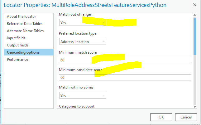

Can I change the default setting from yes to no when creating a street address role locator rather than changing it in the locator properties? For that matter, can I change any of the other properties like Scores etc in a python scripting environment rather than manually after the fact?

Joe,
If you use updateLocator () after modifying the locator settings in Python, the properties get persisted into the locator for future use. If you don't call the updateLocator () method, the properties will only be applied for that session of geocoding in Python.

Thanks Dan! I this might have been what I was thinking of ,
Unfortunately, it appears that the only way to change properties of a locator and have them permanent is to interact with the locators properties pane. If I were to geocode a table of addresses using python the Locator class and properties discussed would be the way to go:
import arcpy ''' set the property''' locatorPath = r'M:\yady_yady\MSD_CenterlinesLocator.loc' locator = arcpy.geocoding.Locator(locatorPath) locator.matchOutOfRange = False ''' do the geocoding ''' addressesTable = r'M:\yady\yady\SomeTable' addressLocator = r'M:\yady_yady\MSD_CenterlinesLocator.loc' addressField = 'Address' resultsFC = r'M\yady\yady\Some.gbd\GecodingResults' arcpy.GeocodeAddresses_geocoding(addressTable, addressLocator, addressField, resultsFC, 'STATIC')
Thanks for pointing that out @BradNiemand !
Just for fun, here is an example of creating a single role street address locator using a feature service for the data source. After the locator is created, a couple properties get changed from the default:
import arcpy arcpy.env.overwriteOutput = True arcpy.SetLogHistory(False) '''Create the locator''' outLocator = r'M:\path\to\MyStreetLocator' language = 'ENG' country = 'USA' inTable = "https://www.path/to/rest/services/myLocation/FeatureServer/9 StreetAddress" fieldMapping = "'StreetAddress.HOUSE_NUMBER_FROM_LEFT 9.FROMADDR_L';"\ "'StreetAddress.HOUSE_NUMBER_TO_LEFT 9.TOADDR_L';"\ "'StreetAddress.HOUSE_NUMBER_FROM_RIGHT 9.FROMADDR_R';"\ "'StreetAddress.HOUSE_NUMBER_TO_RIGHT 9.TOADDR_R';"\ "'StreetAddress.STREET_PREFIX_DIR 9.PREDIR';"\ "'StreetAddress.STREET_NAME 9.NAME';"\ "'StreetAddress.STREET_SUFFIX_TYPE 9.POSTTYPE';"\ "'StreetAddress.STREET_SUFFIX_DIR 9.POSTDIR'" arcpy.geocoding.CreateLocator(country, inTable, fieldMapping, outLocator, language) '''With the Locator created set the default properties''' locatorPath = f'{outLocator}.loc' locator = arcpy.geocoding.Locator(locatorPath) locator.matchOutOfRange = False locator.minCandidateScore = 75 locator.minMatchScore = 75 locator.categories = 'Street Address,Intersection' locator.updateLocator()
