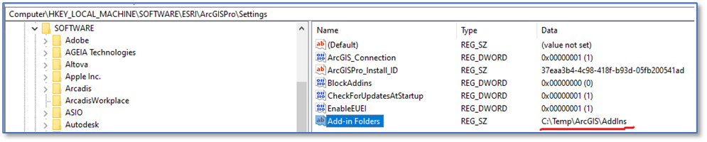

I added the registry key

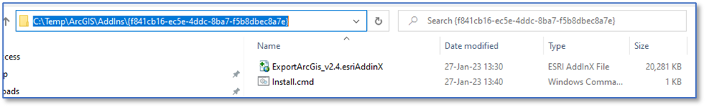

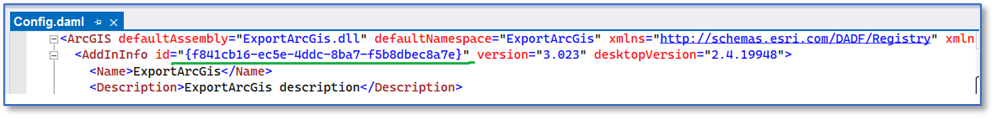

Added subfolder with AddInInfo id as name.

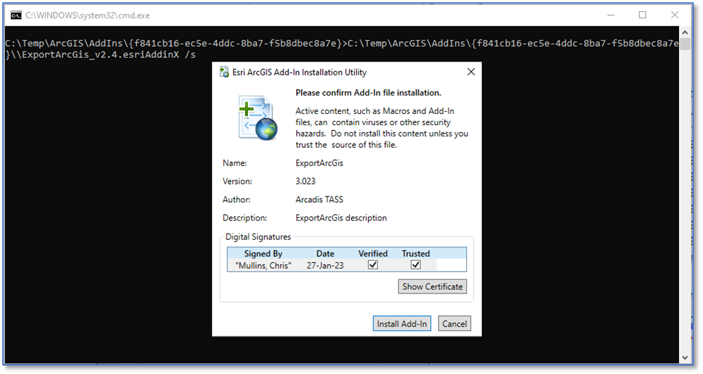

Try to run the installation silently, but it’s still asking for user interaction.
What am I doing wrong?
