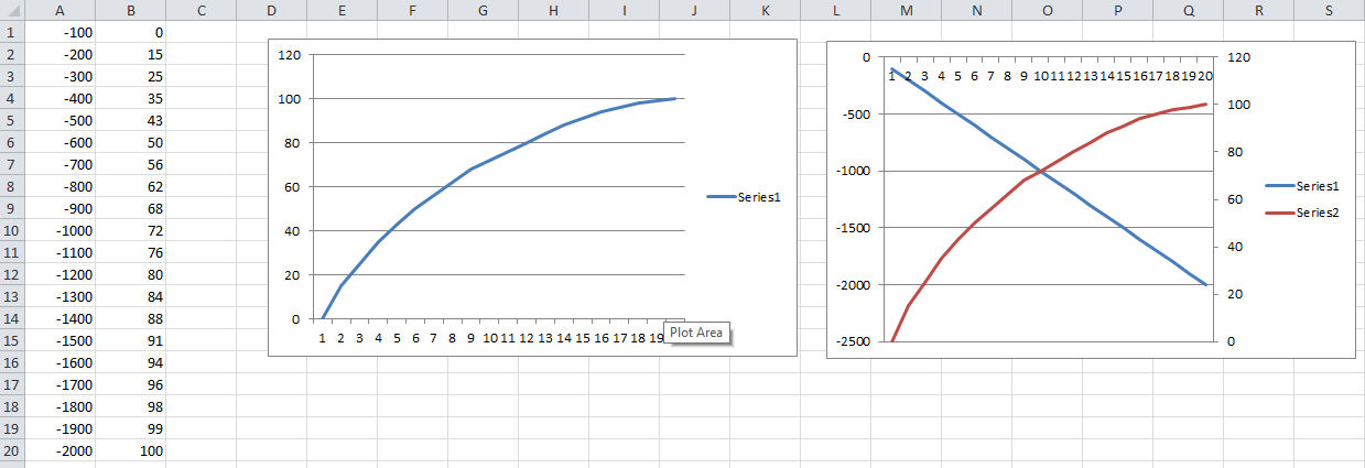

One of the things I've been doing for years with ArcGIS for polygon boundaries, whether it be counties, settlement areas, coastlines, etc., is to have what a graphic designer in a vector illustration package would consider a transparency blend effect on an object, be applied to any type of polygon. I apply this kind of affect to boundaries because I might want a colour that denotes a particular theme be visible to along the boundary of a polygon and dissipate as one moves inside the polygon. Typically when you have a thematic colour applied to polygons you can have issues discerning the boundary thematic colour when a neighbouring polygon shares the same geometry. If you have a transparency effect starting with 0 transparency at the polygon edge and going to 100% transparency at some distance inside the polygon then you can always see the thematic colour of that polygon regardless of adjacent polygons sharing that same geometry. In order to do this I've been using the multi-ring buffer tool on polygons, whether they be counties, urban areas, settlement regions, landmasses, etc. so that I can have a thematic colour scheme for polygons, while still allowing the underlying thematic elements, such as roads, lakes, or other elements be visible, but yet underneath this boundary layer. When I generate the multi-ring buffer, I make a transparency field having an increasing transparency value per interval (see below).
You can see that a linear curve doesn't look as nice as a the decreasing interval curve (red line) in the second graph.
I will usually create a non-linear set of transparency values so that I can have a curved transparency blend as one goes from 0% transparent to 100% transparent.

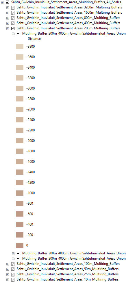

I create multiple sets of these multi-ring buffer transparency layers with zoom layering enabled for each set so that as I zoom in and out of a map I can have roughly the same distance of a gradient fill applied to the polygons.
I've only expanded one of the groups, but the Sahtu (red) and Inuvialuit (purple), have the same look as the Gwich'in (brown). Yes this is a complex solution but works quite well to visualize maps.
