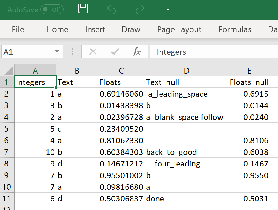

(1) ---- Spreadsheets gone bad
Here is a spreadsheet with so flubs builtin.
Column A contains integers, but excel treats them as just floating point numbers without a decimal place.
Column D is just text but with leading/trailing spaces, cells with spaces, empty cells and just about anything that can go wrong when working with text.
Column E has floats but two of the cells are empty or worse... a space.
All these conditions need to be fixed.

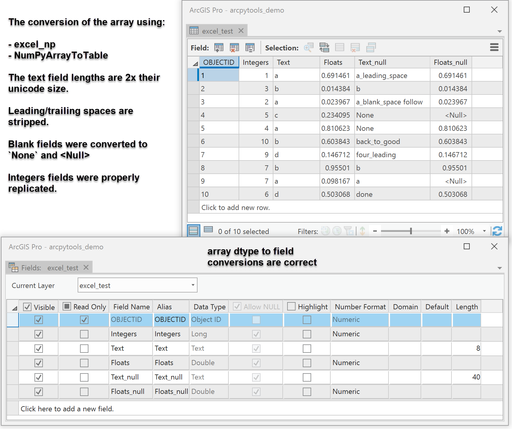

(3) ---- Spreadsheets to array to geodatabase table
Now... The array can be converted to a geodatabase table using NumPyArrayToTable.
arcpy.da.NumPyArrayAsTable(array, path)
where
`array` is from the previous step
`path` the full path and name of the geodatabase table.
it comes in as expected. The dtypes are correct and the text column widths are as expected. Note that text column widths are twice the Unicode dtype width (ie U20 becomes 40 characters for field length)

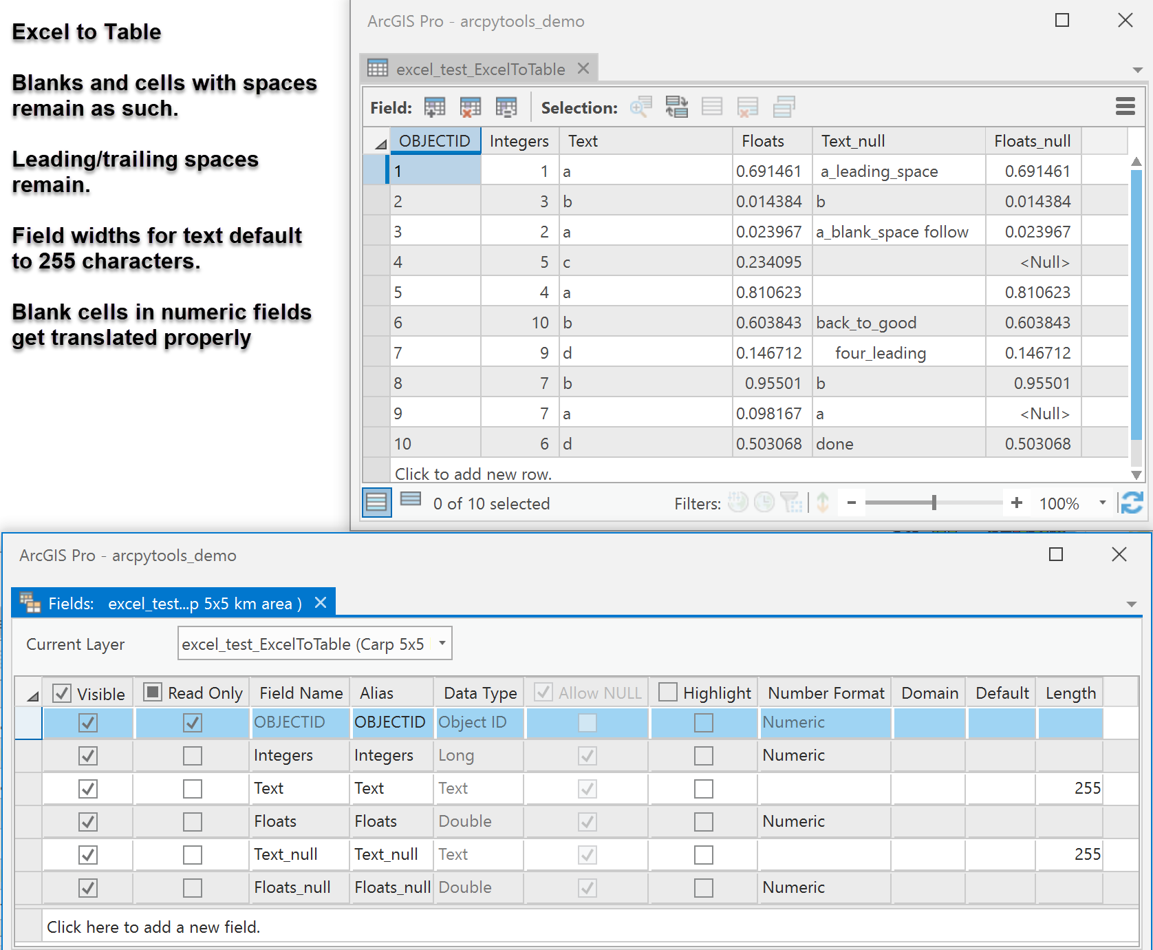

(4) ---- Spreadsheets to geodatabase table via arcpy
Excel to Table does a good job on the data types, but it takes some liberty with the field length. This may be by design or useful or a pain, depending what you intend to do with the data subsequently.

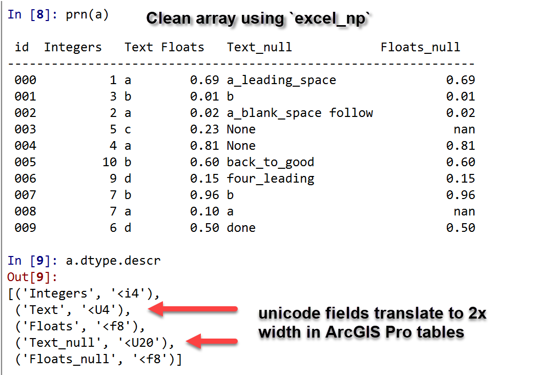

excel_np.py .... convert excel to a structured array
There are some things you can do to ensure a proper data type. The following demonstrates how one little blank cell can foul up a whole column or row of data.

(7) ---- End notes...
So the next time you need to work with spreadsheets and hope that the magic of xlrd, openpyxl or pandas (which uses both) can solve all your problems.... take the time to look at your data carefully and decide if it is truly in the format you want BEFORE you bring it into ArcGIS Pro as a table

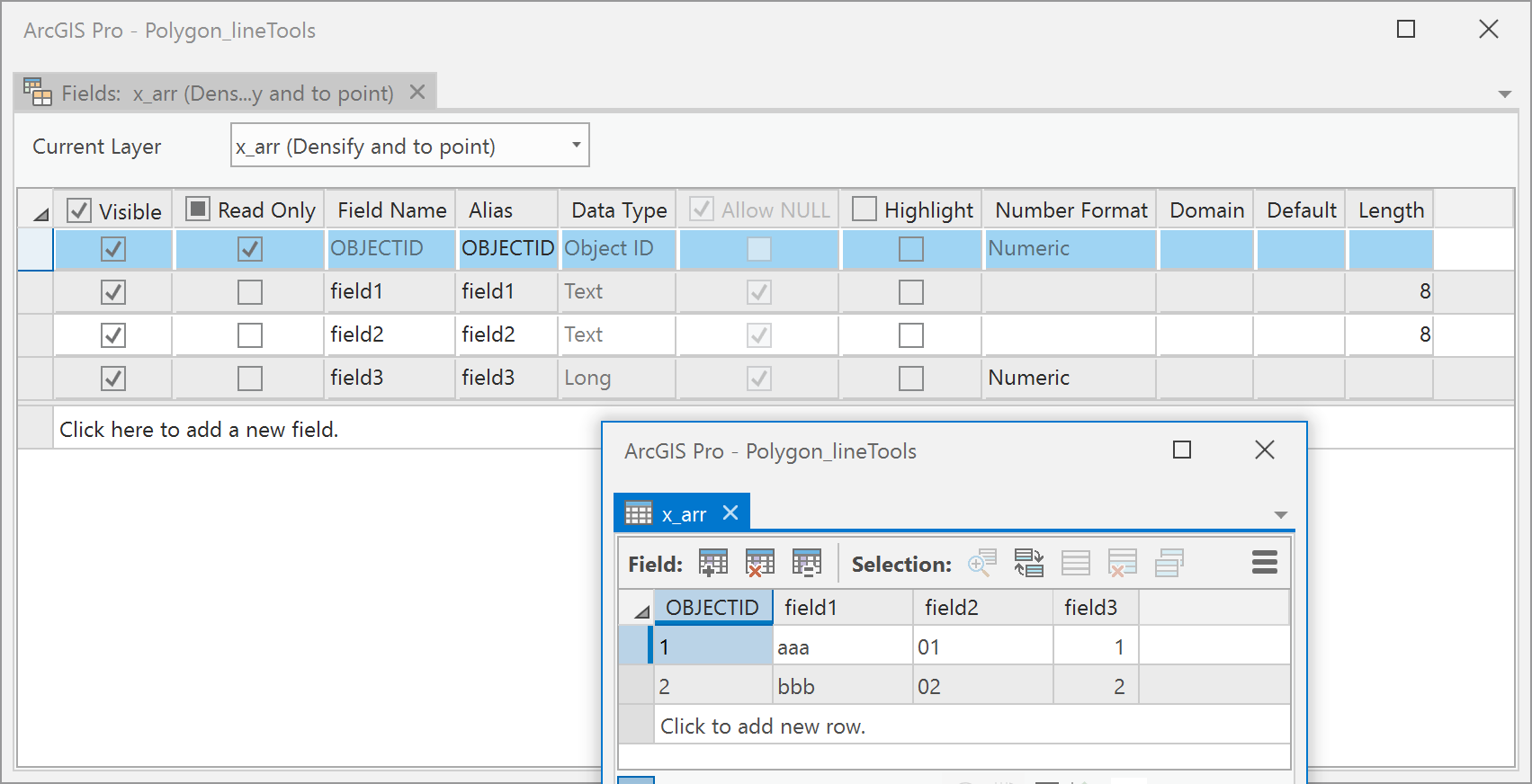

<SPAN class="keyword token">import</SPAN> arcpy
arcpy<SPAN class="punctuation token">.</SPAN>da<SPAN class="punctuation token">.</SPAN>NumPyArrayToTable<SPAN class="punctuation token">(</SPAN>arr<SPAN class="punctuation token">,</SPAN> r<SPAN class="string token">"C:\Your_spaceless_path_to\a.gdb\x_arr"</SPAN><SPAN class="punctuation token">)</SPAN><SPAN class="line-numbers-rows"><SPAN></SPAN><SPAN></SPAN><SPAN></SPAN><SPAN></SPAN><SPAN></SPAN><SPAN></SPAN><SPAN></SPAN><SPAN></SPAN><SPAN></SPAN></SPAN>An example for a very simple table
