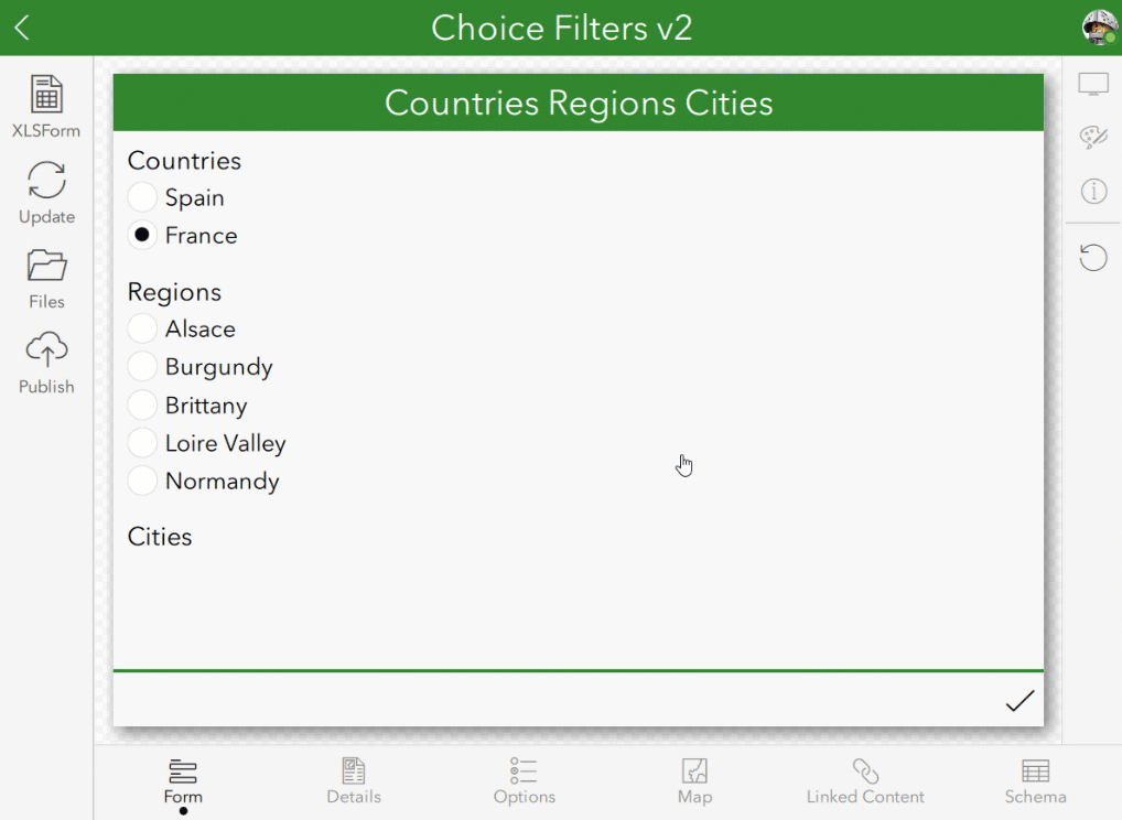

In XLSForm jargon, choice filters are often associated with the notion of 'cascading selects'. The idea is that a selection in one list, determines which values will be presented in the following list. Say we have a list of countries, and a second list of regions. As you select a country in the first list, you want the second list to just show regions for that country.

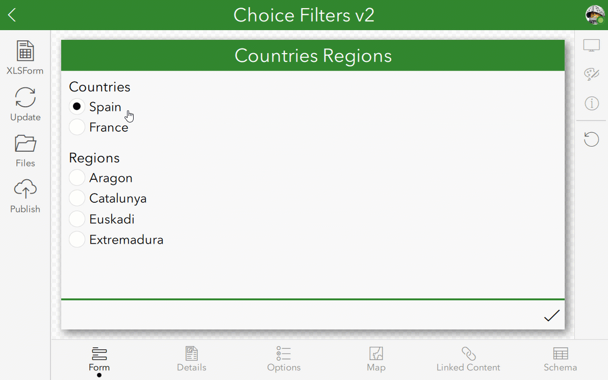

Below is what the countries and regions cascading select example could look like:

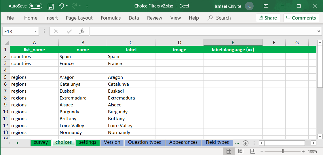

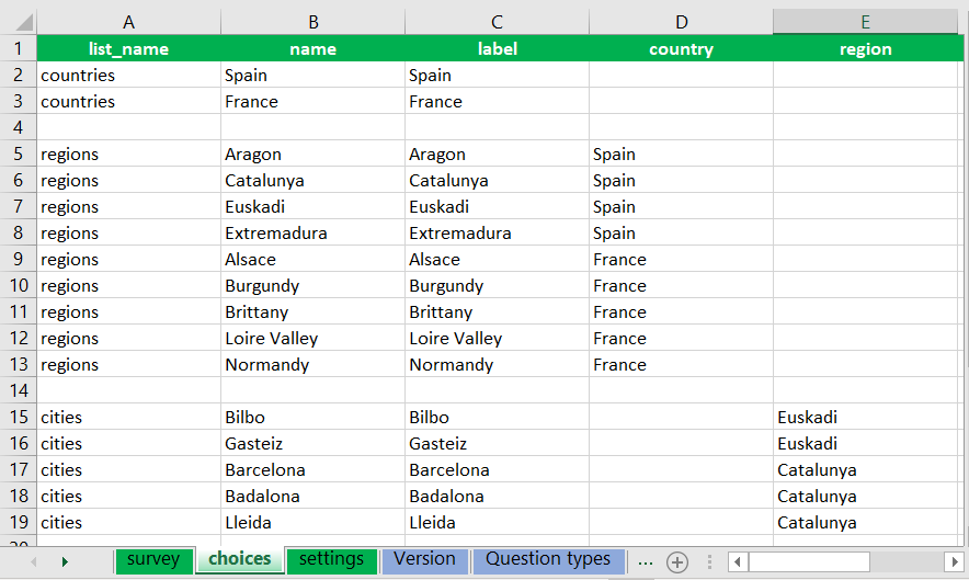

- Switch to the choices worksheet and add the countries and regions lists as shown below:

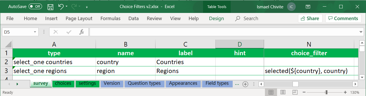

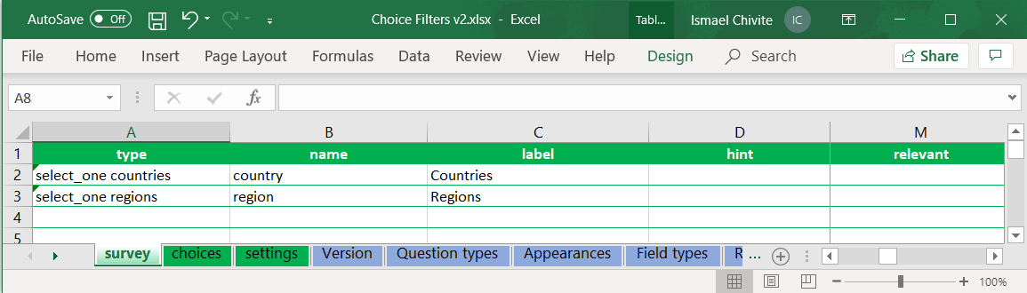

- Now switch to the survey worksheet and add two select_one questions.

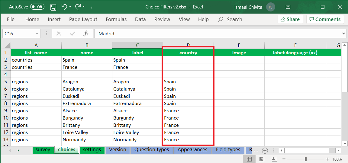

- Switch back to the choices worksheet and add a new country column to the worksheet. This new column can be called whatever you like, but in our case we will call it country.

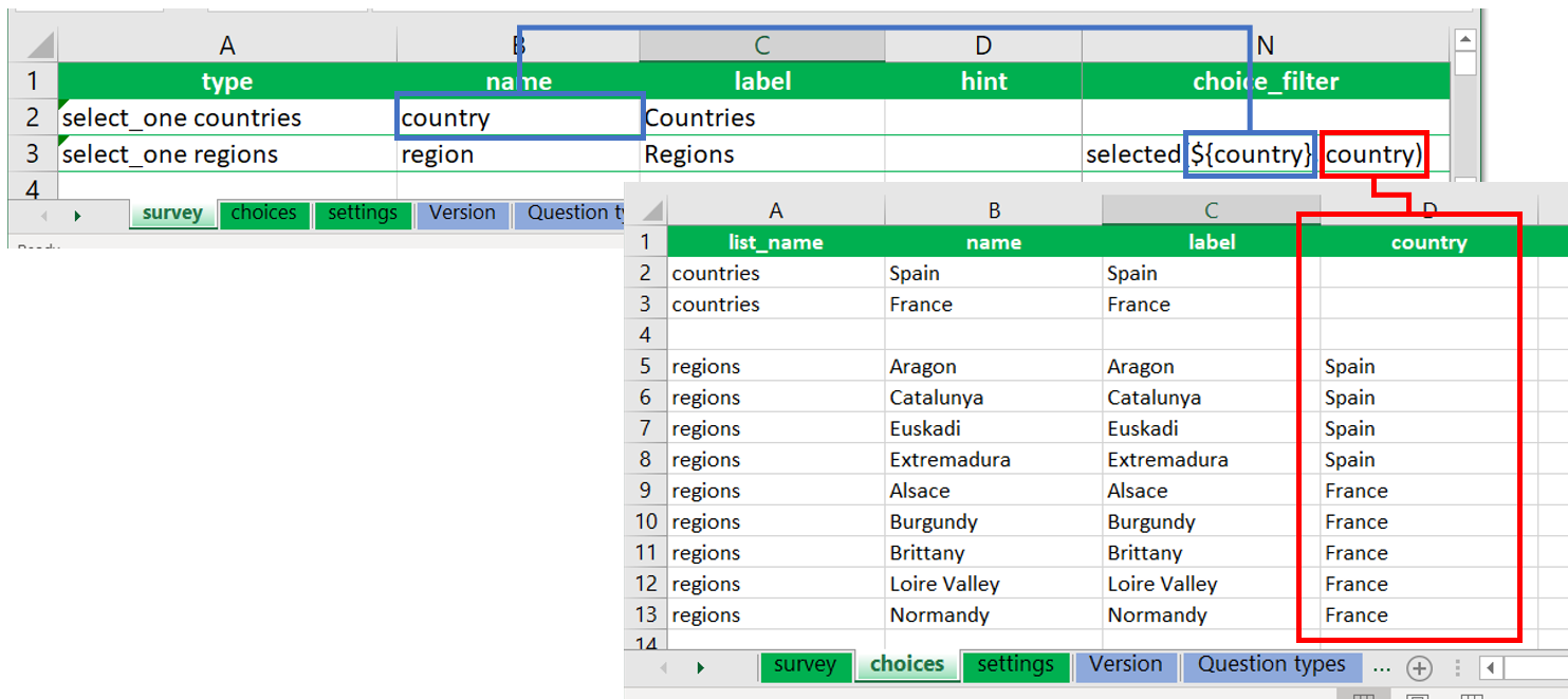

- For each of the rows in the regions list, populate the country column accordingly. The values in this column must match the name values from the countries list.

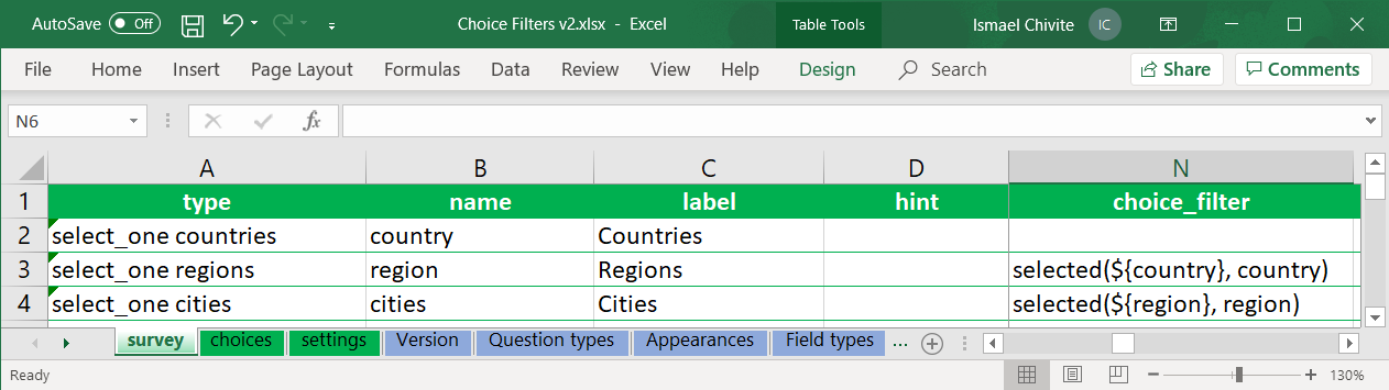

- Now that the choices worksheet specifies the country for each of the regions, we can define a choice filter in the survey worksheet.
- Switch to the survey worksheet and look for the choice_filter column. Apply the following expression to the region question: selected(${country},country)

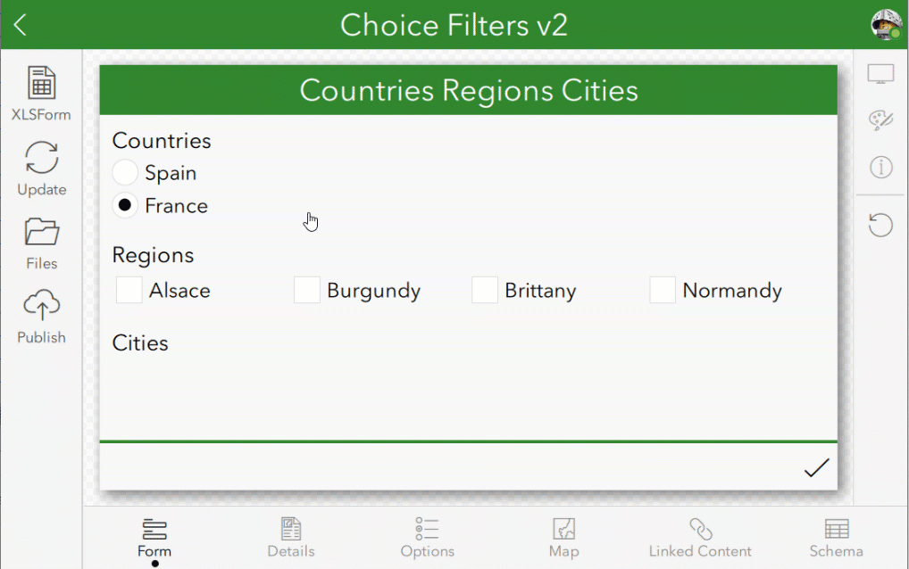

- Save your spreadsheet and preview your changes in the Survey123 Connect preview. Now your cascading select should work as expected: As you select a country, the list of regions changes accordingly.
As you can see the concept is simple: The expression in the choice_filter column of a select question determines which elements of the list will be displayed. In the choice_filter expression you can reference questions from your survey and custom columns from the choices worksheet. In our scenario, the expression was selected(${country},country). The choice_filter expression is evaluated against every choice in the region list. If the expression evaluates to true, then the choice is kept. If the expression evaluates to false, the choice is dropped.
If you have been using choice filters for a while with Survey123, I bet your choice_filter expression would have looked like this: country=${country} instead of selected(${country},country). Both expressions are correct. We will talk more about the differences between these two expressions, and when to best use one or the other, later in this blog in the 'Working with very large lists'.

In the choices worksheet, note that I added a new region column for the cities list.
In the survey worksheet, I added a new select_one question for the cities and its corresponding choice_filter.

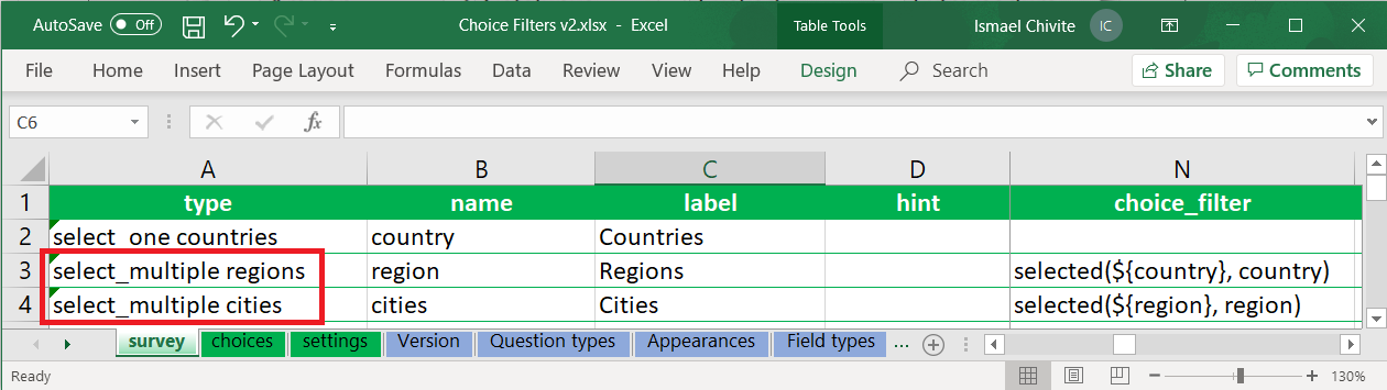

You can apply choice filters to select_one and select_multiple questions. In the example below, note that I converted the regions and cities questions into checklists. Say for example, you visited Spain. Then I want users to select all the regions they visited in Spain, and also all the cities visited within these regions.
To do the above, I simply changed the type of questions from select_one to select_multiple. Since the selected() function works for all select questions (select_one and select_multiple), you do not need to change the choice_filter.

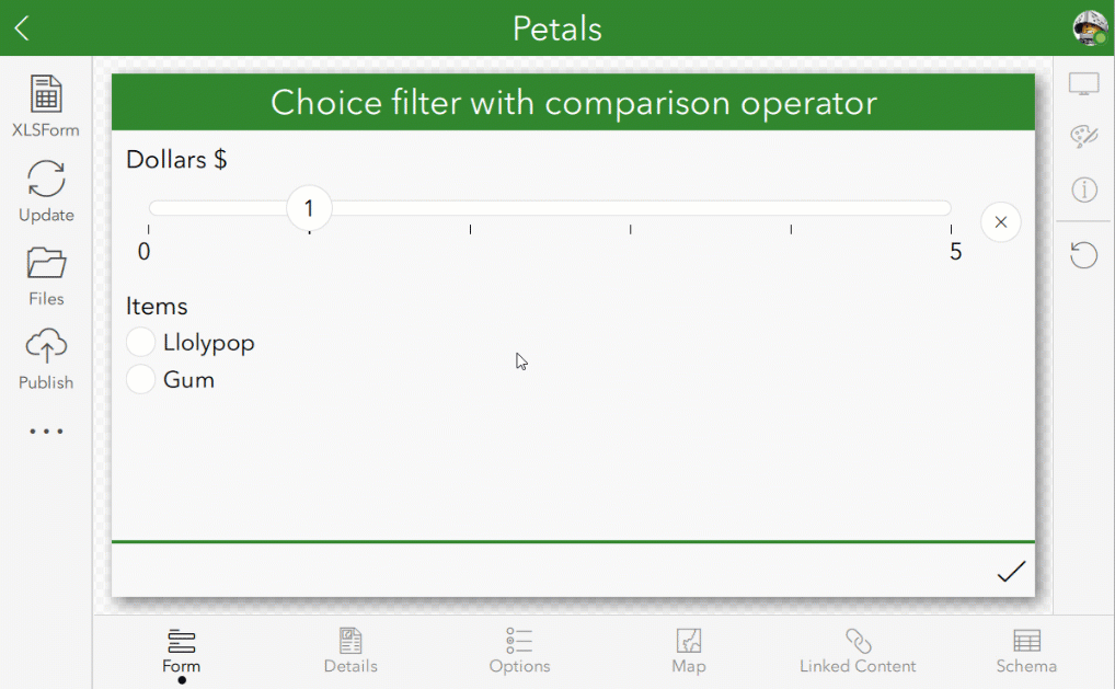

- Filters on numeric values: If the choice list custom column contains numeric values instead of text, the > (greater than), < (less than), = (equal), etc. comparison operators will be useful. Below is an example using price<=${dollars} as a choice filter. The range question at the beginning sets a numeric value (the dollar amount), which is compared against the price custom column added in the items choice list.

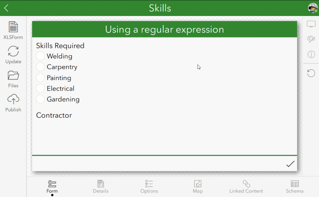

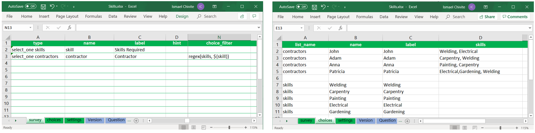

- Functions on strings: Other than the selected() function and = operator, which we already described, there are other functions you can use to work with strings. Let's pretend we need some work done by a contractor. We want to use a first list to define the work that needs to be done. The list of contractors needs to be filtered to show only the contractors with the necessary skills.
Unlike the countries and regions example we explored earlier, in this case elements from the filtered list can appear multiple times. For example, Patricia is an electrician, gardener and welder. As shown in the screenshot below I added a skills column to the contractors list. This column includes a comma separated list of the skills of each contractor.
To find if a particular skill is present within the skills column, we can use a regular expression such as regex(skills, ${skill}). Alternatively, we can also use contains(skills, ${skill}). Other string functions such as starts-with() or ends-with() can be handy as well.

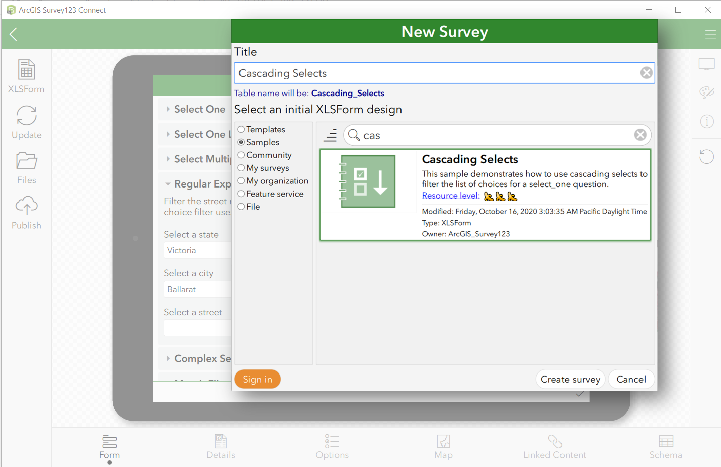

As usual, using the survey samples that come with Connect is often the best. In Survey123 Connect, create a new survey and select the Cascading Select sample. You will find in there a few additional great examples illustrating the different patterns you can follow to create filter expressions.

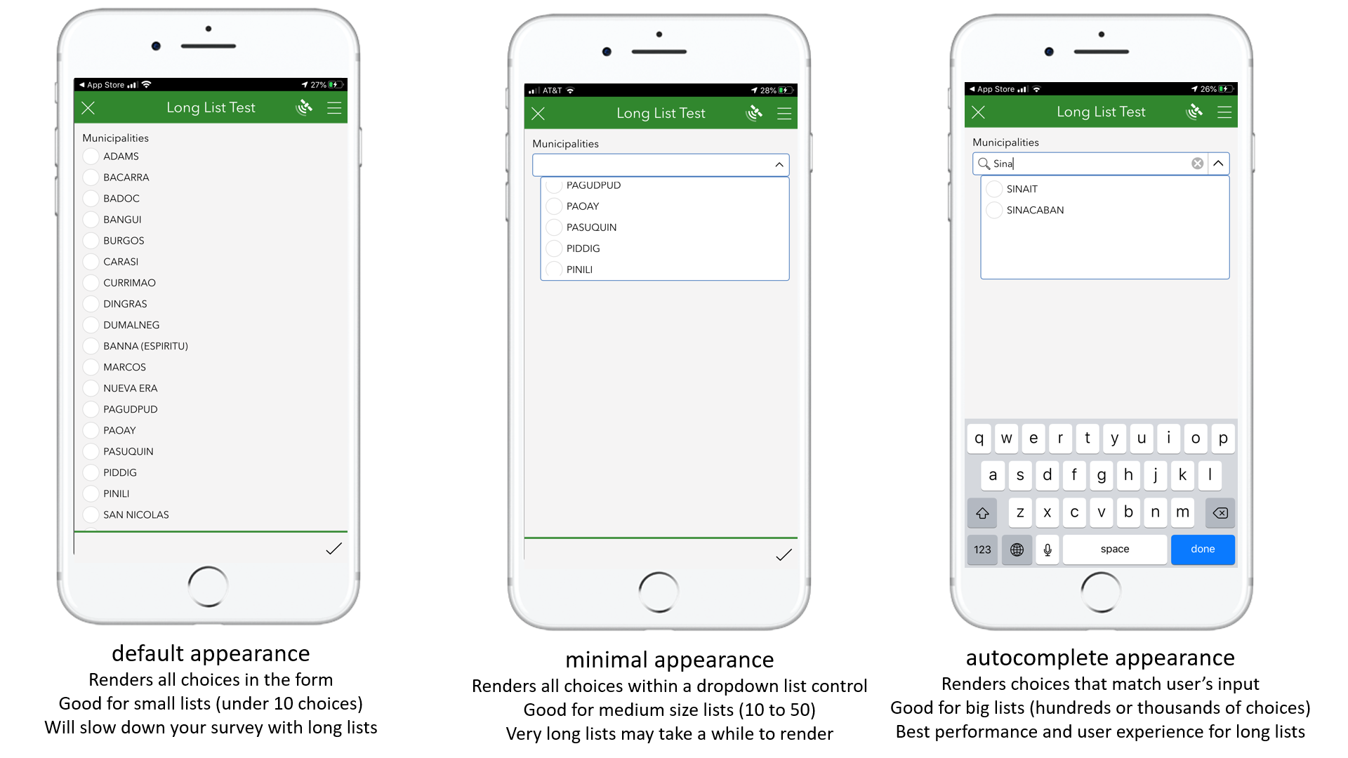

Survey123 supports multiple ways to display lists. By default, choices in a list are directly presented in the form. In this way, end users can see right away all the choices and tap on them quickly. This default appearance, is great for very small lists (under 10 elements). For lists that grow larger, this default appearance is not adequate because it forces users to scroll the entire form in order to see elements at the bottom. If the list grows even larger, the initial loading time of your form will be negatively affected because the default appearance forces Survey123 to render every choice in the list within the form.
Using the XLSForm minimal appearance , you collapse list choices into a dropdown control. Everyone wins: end users do not need to scroll up and down the entire form, and Survey123 does not need to render the entire list until the user chooses to open the dropdown. When working with long lists, the minimal appearance reduces the initial survey loading time.
You can also use the autocomplete the appearance. With autocomplete, the dropdown list will not show any choices until the user starts typing. This also saves time because only elements in the list that match the user input need to be rendered. For very long lists, autocomplete is often the best option for both the end user as well as to speed up your survey behavior.
Ultimately, you will need to choose what appearance works best for you. The performance differences of these different options will vary depending on your device too. As I wrote this article, I measured how much time a list with 1,500 elements took to load using the different appearances. Autocomplete was the winner. It reduced loading time 400% when compared to the default appearance and it was also slightly faster than the minimal appearance.
