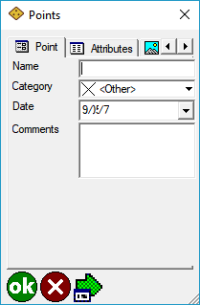

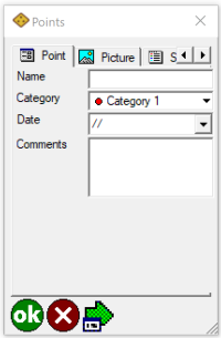

Squashed dates
OK this is a weird one and we don't have a definitive explanation yet!
The good news is that it doesn't effect the date that is saved to your data. If you enable the Attributes table on your form, you can see that the date that you selected in the date picker is correctly stored. It is only the appearance on the form that is effected.
And on two different different machines we have observed two different appearances. See the screenshots below, on one the date is squashed so much you can not see any numbers, on the other you can partially see the numbers.
Please let us know if you also experience this date issue, or any other unexpected behavior after updating your Windows 10.
