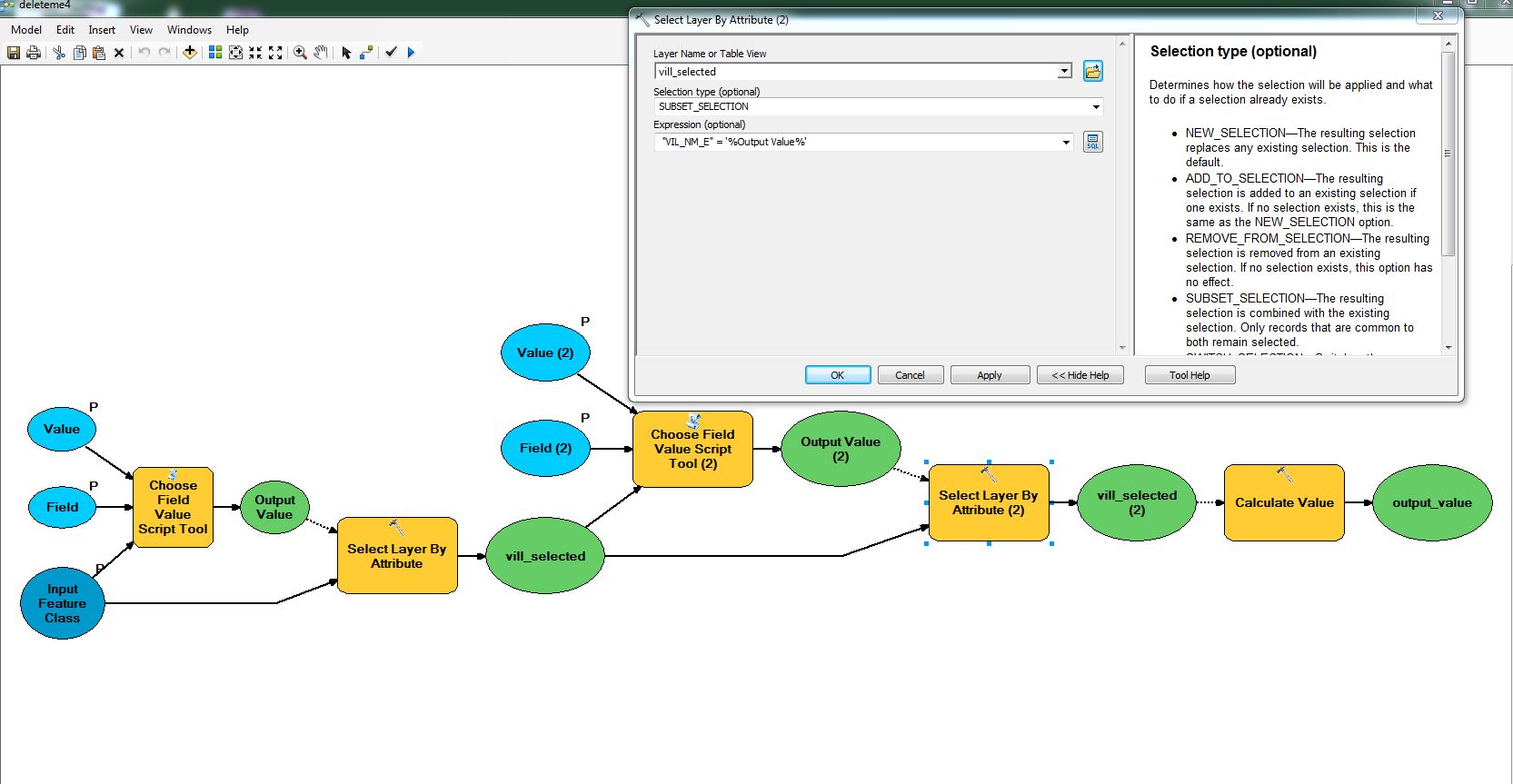

Through my many failed attempts I decided to make the model (for testing purposes) with only one variable and not use all the aforementioned variables, just to see if it works, which it does (screenshot 1). For example the user to select a District or to select a Town as different models each time.

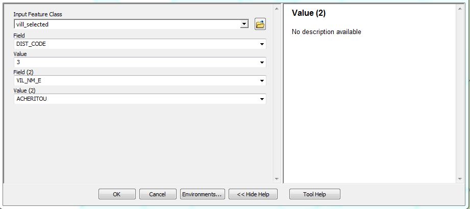

I attached a screenshot (screenshot 2) of my model, with the use of the first two variables (District and Town/Village).

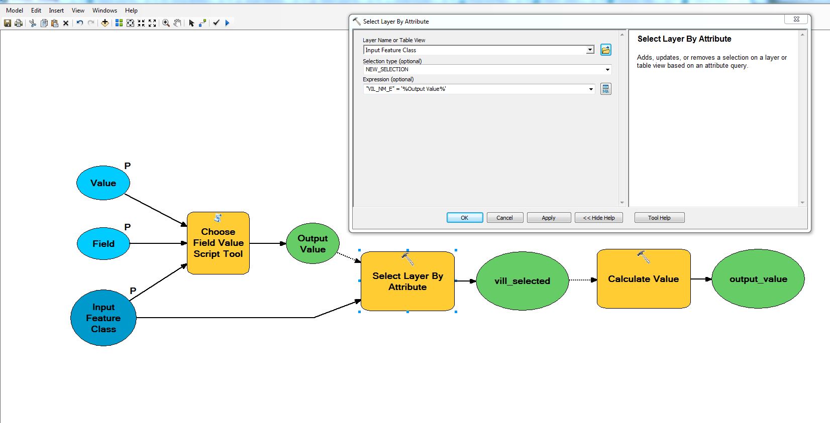

When I run the tool, at the interface (screenshot 3), the second selection (Value (2)) does not populate the values based on the first selection (Value), instead it shows all the values of the field (Field(2)), and then nothing runs as it supposed to do. For example if in the second “Select by attributes” tool (screenshot 2), I have as a “Selection Type = SUBSET_SELECTION”, nothing gets selected so the zoom doesn’t work. If in the second “Select by attributes” tool (screenshot 2), I have as a “Selection Type = ADD_TO_SELECTION”, it selects all the rows that have the same “Dist_code” and doesn’t take account the Town/Village.
