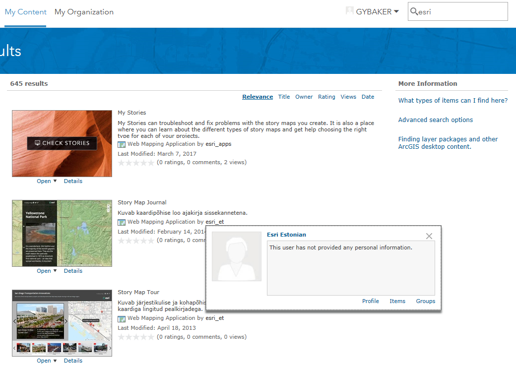

We're about to launch an internal Portal site with a couple of main apps that we want to direct initial users towards. We're keeping what they can do on the site down to a bare minimum and will roll out more of the Portal functionality over time. One behaviour that we've just noticed is when searching for content with a phrase such as "esri" - which returns 645 items - see attached screenshot.
It looks as if the search is returning a lot of internal items such as regional variations for each of the different Story Map templates. When you click on the content owner these appear to be some sort of internal ghost accounts rather than Portal members.
I know the likelihood of users searching on something like esri is probably quite low but we'd prefer it if these items didn't get returned at all in any searches and instead only content that we'd approved via the standard sharing mechanisms were shown.

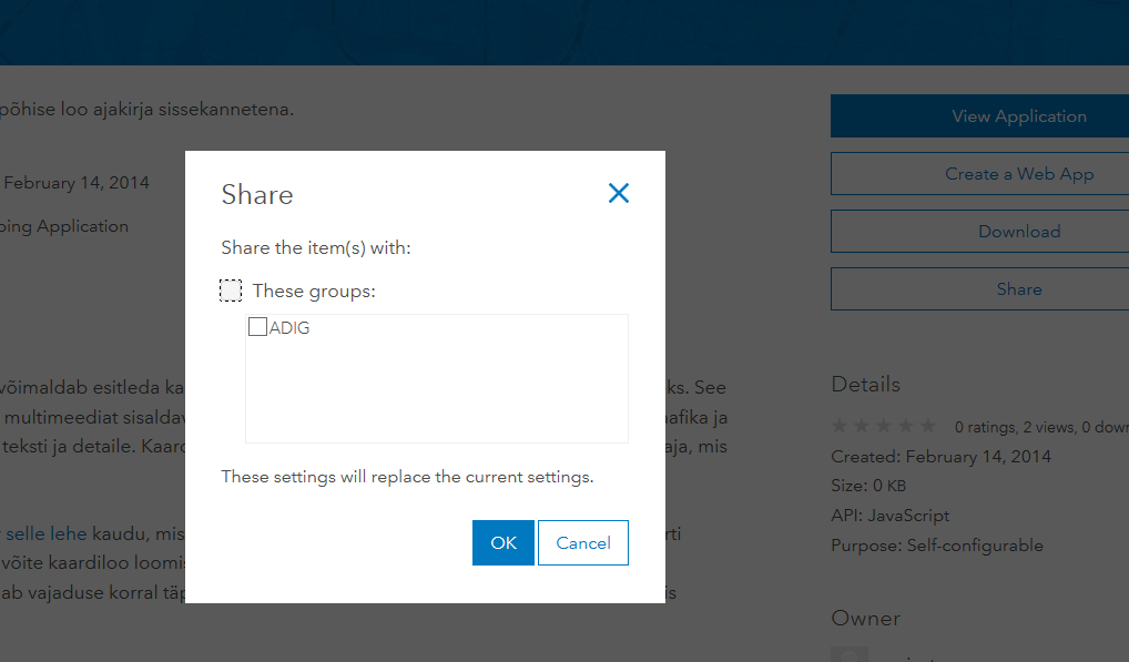

If I try to change the sharing on one of the items so that they aren't visible to general users then I only get the option to share with groups that I own (even as an admin) rather than the Everyone and Portal options that you get with "normal" Portal content items.
