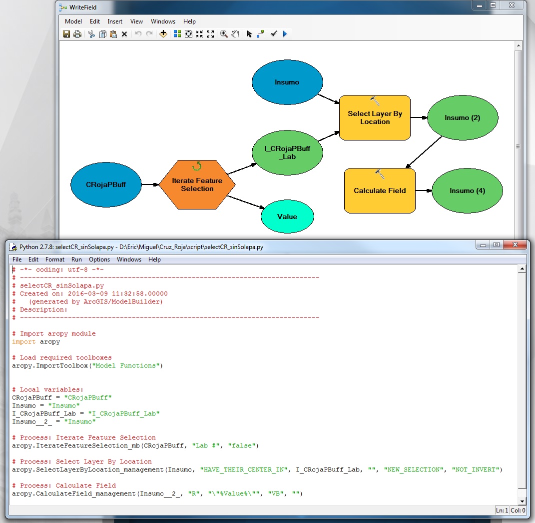

I'm trying to write in test field from some layer based on iterate feature selction. I get succes using model builder but I'm fail when I try with my own code.
The process with MB.

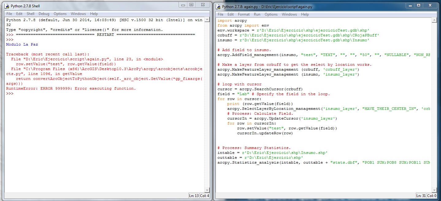

The code and error.
Here is the code.
- import arcpy
- from arcpy import env
- env.workspace = r'D:\Eric\Ejercicio\shp\ejercicioTest.gdb\shp'
- crbuff = r'D:\Eric\Ejercicio\shp\ejercicioTest.gdb\shp\CRojaPBuff'
- insumo = r'D:\Eric\Ejercicio\shp\ejercicioTest.gdb\shp\Insumo'
- # Add field to insumo.
- arcpy.AddField_management(insumo, "test", "TEXT", "", "", "50", "", "NULLABLE", "NON_REQUIRED", "")
- # Make a layer from crbuff to get the select by location works.
- arcpy.MakeFeatureLayer_management (crbuff, 'crbuff_layer')
- arcpy.MakeFeatureLayer_management (insumo, 'insumo_layer')
- # loop with cursor
- cursor = arcpy.SearchCursor(crbuff)
- field = "Lab" # Specify the field in the loop.
- for row in cursor:
- print (row.getValue(field))
- arcpy.SelectLayerByLocation_management('insumo_layer', "HAVE_THEIR_CENTER_IN", 'crbuff_layer', "", "NEW_SELECTION", "NOT_INVERT")
- # Process: Calculate Field.
- cursorIn = arcpy.UpdateCursor('insumo_layer')
- for row in cursorIn:
- row.setValue("test", row.getValue(field))
- cursorIn.updateRow(row)
- # Process: Summary Statistics.
- intable = r'D:\Eric\Ejercicio\shp\Insumo.shp'
- outtable = r'D:\Eric\Ejercicio\shp'
- arcpy.Statistics_analysis(intable, outtable + "stats.dbf", "POB1 SUM;POB8 SUM;POB11 SUM;POB14 SUM;POB15 SUM;POB16 SUM;POB24 SUM;POB31 SUM;POB57 SUM;MIG7 SUM;INDI1 SUM;DISC1 SUM;DISC4 SUM;DISC5 SUM;DISC6 SUM;ECO1 SUM;ECO4 SUM;ECO25 SUM;ECO28 SUM;SALUD1 SUM;SALUD2 SUM;SALUD3 SUM;SALUD4 SUM;SALUD5 SUM;SALUD6 SUM", "test")
