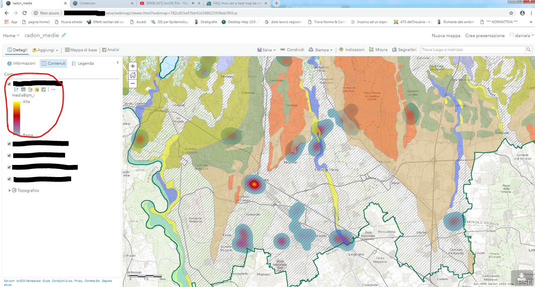

ほかの人にも起きているのかはわかりませんが、最近AGOLでウェブマップ上のポイントレイヤーをスタイル設定するためにヒートマップ機能を試したところ、TOCでは最上位にあるにもかかわらず、ほかのレイヤーの背後に表示されてしまいます。なぜこうなるのか、わかる方はいませんか?
Hi Alessandro,
By design, feature layers are always displayed on top of heat maps. It is not possible to move a heat map above other features layers in the ArcGIS Online map viewer. An alternative is to create a tile package for the feature layers in ArcMap/Pro and publish the tile layer to ArcGIS Online. Once published, open the tile layer and the heat map in a map viewer and it will display on top of the tile layer.

There is currently an enhancement for the documentation to be updated to reflect that this is by design. ENH-000090365: Update ArcGIS Online Help (for ‘Change Style’ subheading: Heat map) to reflect the known limitation when using heat map symbology. This symbology will automatically appear under all other layers regardless of the layer order in the map contents.

Thank you, it is clear now.
One question: do I need to import the web feature layer of the heat map published on AGOL in ArcMap, make it a tile packageand do the rest of what you said?
Because, as far as I know, it is not possible to produce a heat map layer in ArcMap, am I wrong?
Thanks for your feedback.
Apparently, I cannot import the hosted heat map layer in ArcMap preserving the symbology. The point layer is symbolized as a unique value. So it seems I have to do it in ArcMap, but I don't know how.
Luba Hristova is there a way to do it in ArcMap and then do what you suggest to have it published to AGOL and be able to have it drawn on top of the other layers?

Yes there is a way to do it and that would be by using any of the tools from the Spatial Analyst toolbox stated in this article:
FAQ: How can a heat map be created in ArcMap?
However, I just did a quick test by:
1: Creating hot spots in ArcGIS Online
2:Connecting to my hosted services in ArcMap
3:Pulling my hot spot map in ArcMap
The symbology preserved and stayed the same as it was in ArcGIS Online, are you not getting the same outcome?
