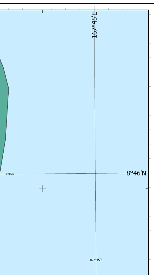

I'm attempting to get masked labels at the edge of the frame.
In this screenshot, the smaller labels are "interior Labels" and the larger are just "Labels" that I have a negative offset on so they are inside the frame. What I want to do is mask the "Labels" the way the "interior labels" are masked, or even just move the interior labels to the edge. Is there any way to do either of those things?
I have a map series with many many maps so doing this manually is not an option.

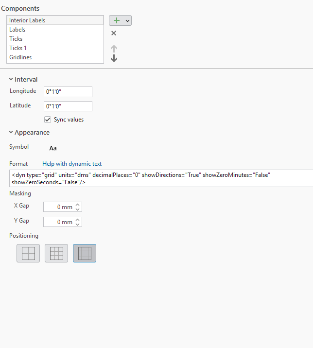

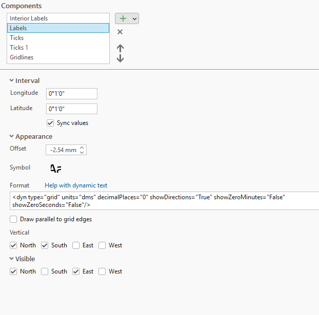

Here are my current settings:
