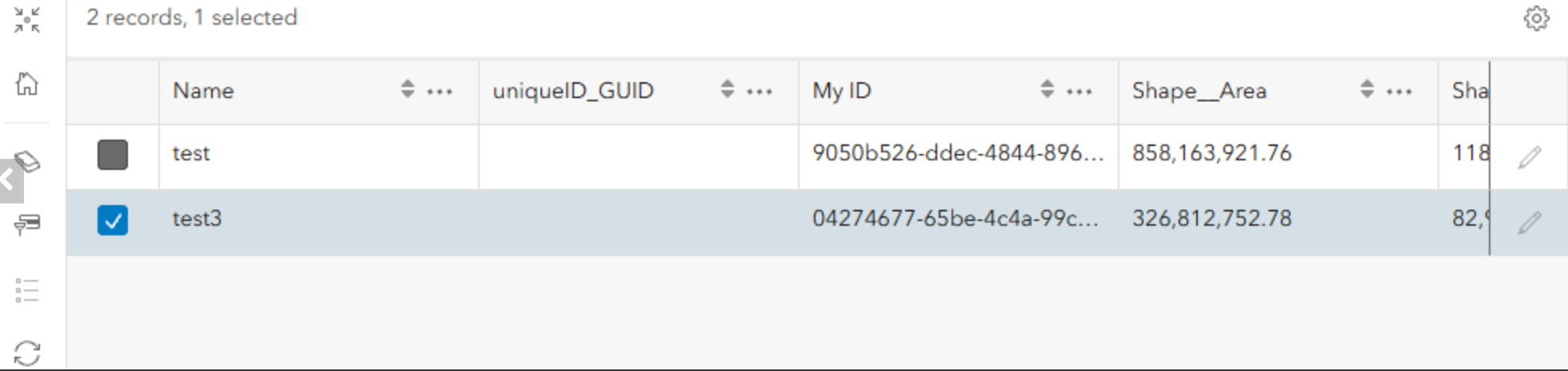

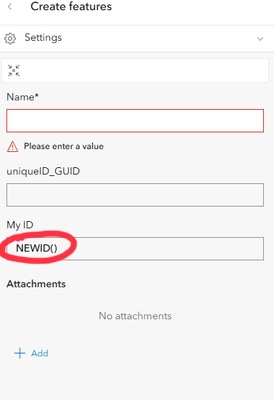

After creating the feature layer, I opened it in a web map and created a feature. At first I was worried because the interface looked like this:
But after submitting the form and checking the attribute table, the value was populated!
I was also confused when the new feature Edit window showed NEWID() as the field value, prior to saving the feature. I thought it was going to insert the literal text “NEWID()” instead of a GUID value, which isn't what I want.
This idea is to display something more intuitive in the Edit tool’s field value text box, such as the GUID value, instead of “NEWID()”.
