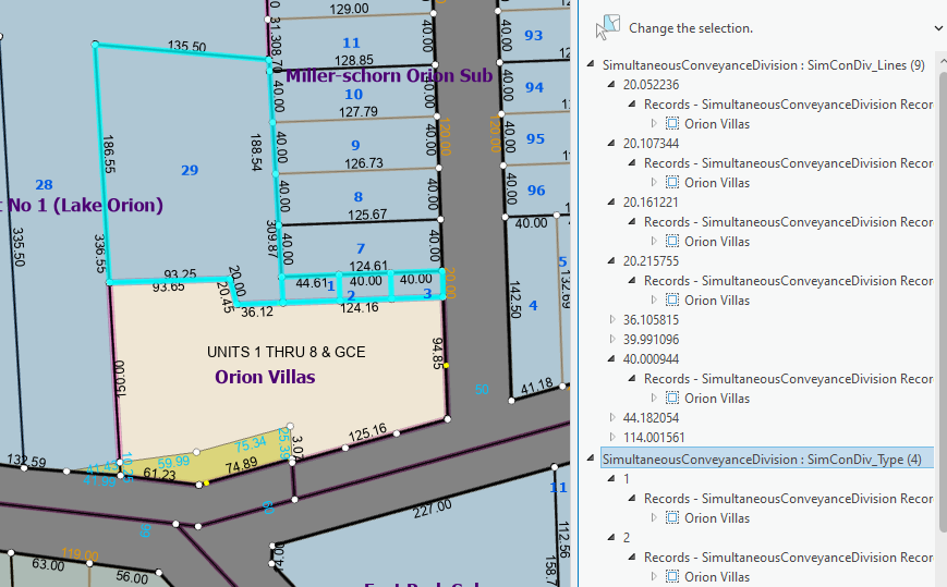

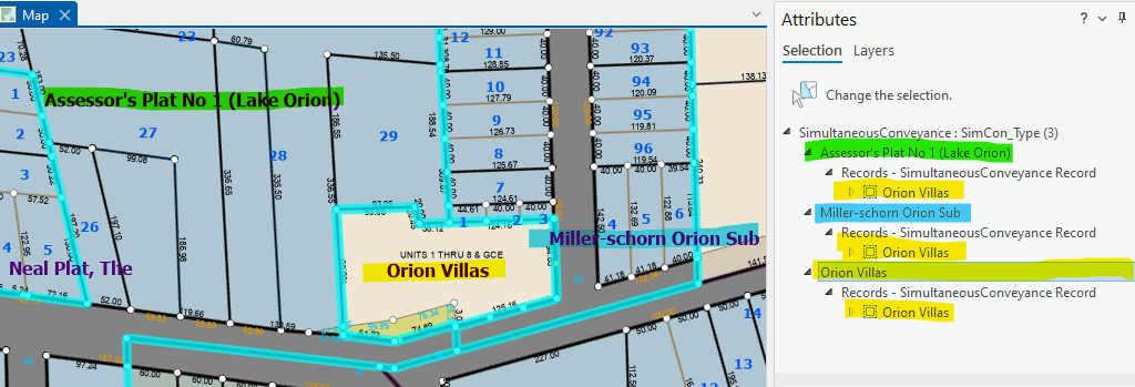

Example 1: In the example below, a new development (SimultaneousConveyance) record supersedes two other development records.
The issues is not limited to only the development (SimultaneousConveyance) layer, but is affecting other layers too. Lots/Units (SimultaneousConveyanceDivision), RightofWay layer, etc.
Example 2: in the example below, you can see highlighted lots and lines (SimultaneousConveyanceDivisions) are under the wrong developent (SimultaneousConveyance) record name..

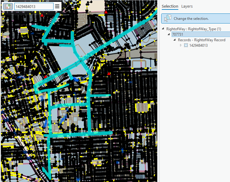

We also have issues with RightofWay features. In our data, a right of way record may contain many features. This is because during the parcel fabric creation, we needed to create a record for the right of ways. We broke them down by geographic township. However, we have found that when a tax parcel split or division is done, the remainder of a RightofWay features become associated with the new record tax parcel record, which it is not.
Example 3: In the example below, the highlighted RightofWay is associated with a tax parcel record, when the remainder from this split or divide should still be kept under the original record.
