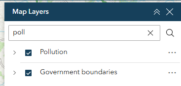

If the search string matches a group name, it will return the group, but when you expand the group, it looks as though the group is empty:
If the search string matches a layer name, it returns the group the layer is in, but doesn't expand the group so you can't see the layer:

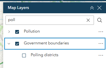

until you expand it:
