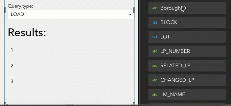

Four new code samples are added. The sample below demonstrates the difference between the Load and Query method when fields from data are selected or deselected. Specifically, the Load method queries and stores records in the data source instance so these records can be shared with widgets. The Query method only retrieves records without storing them. See How to use fields for details.

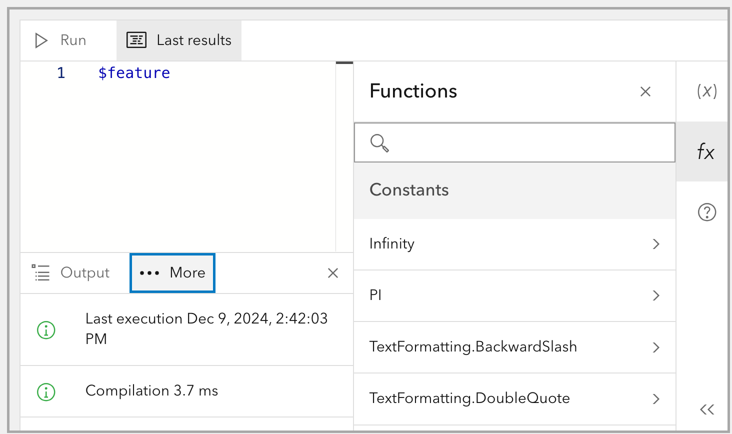

The Use coding components sample demonstrates how to use Coding components from ArcGIS Maps SDK for JavaScript in a widget. It loads the coding components from CDN and uses the Arcade editor component from the package to render the Arcade editor. The widget shares the same experience as you would edit Arcade expressions in Map Viewer.

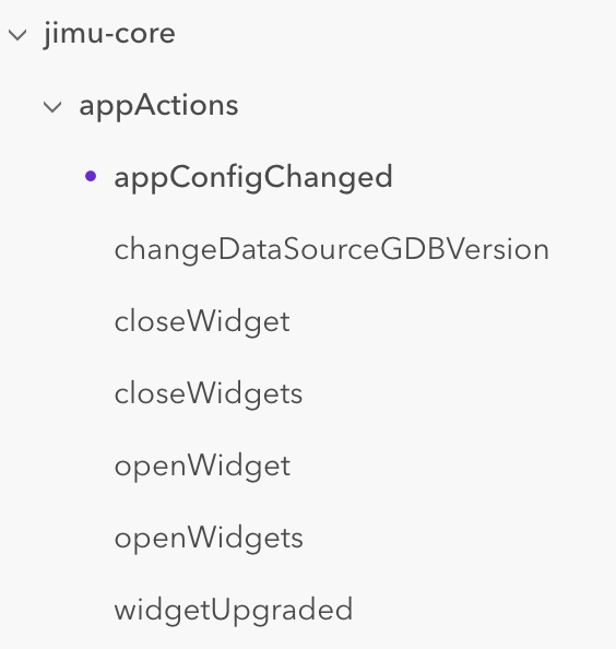

More APIs are added to jimu-core in API Reference, including appActions, extensionSpec, UrlManager. Taking appActions as an example, it shows action methods such as opening and closing widgets in the app.

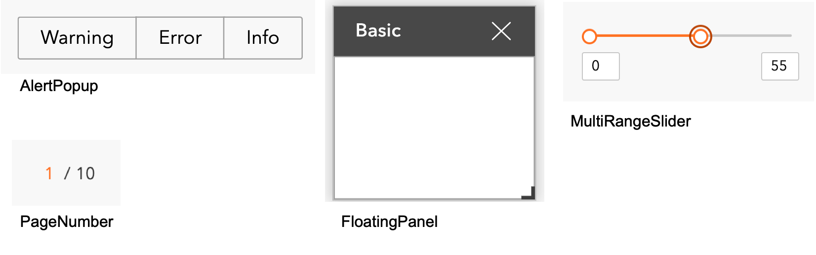

In addition, more components are added to Storybook, including AlertPopup, FloatingPanel, MultiRangeSlider, PageNumber, and MobilePanel.
