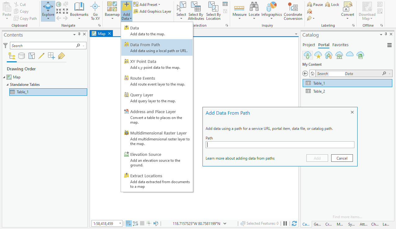

Using the Add Data From Path option from the Ribbon > Add Data menu:
I can add an entire hosted feature service to the map using the URL that I got from a feature layer's Properties > Source:
https://services7.arcgis.com/<removed>/arcgis/rest/services/New_File_Geodatabase_gdb/FeatureServer
But as far as I can tell, I can't add a specific table using a URL.
I tried adding /Table_1 to the end of the URL, but when I clicked Add in Add Data From Path, the dialog closed, but nothing happened; no layers were added.
Could Pro be enhanced so that we can add a specific table to the map using the Add Data From Path dialog?
Use case: Reset feature layer properties.
