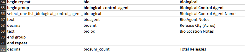

I'm new at creating equations in xls format and I'm struggle with getting this equation to function for a survey in survey 123.
I get this error in survey 123 : "TypeError: Value is undefined and could not be converted to an object in expression: sum(indexed-repeat( /Form_1/bio/biological_control_agent/bioamt , /Form_1/bio , position (..)))"
The equation is: sum(indexed-repeat(${bioamt}, ${bio}, position (..)))
The table below is a copy from the form I'm working with (maybe I don't' have the layout correct?)
Any help or insight would be greatly appreciated.
