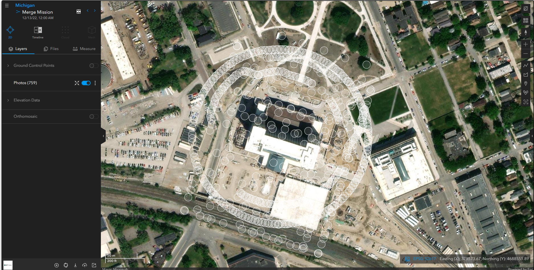

Site Scanがユーザーに地図上で描画したエリアを通じて複数の写真を選択し削除できる機能を提供できれば素晴らしいと思います。現在、画像が地図上に表示されていて外れ値を削除したい場合、通常は画像の特定の名前や番号を選択する必要があります。このプロセスは、削除したい画像の周りにエリアを描いて選択できれば大幅に改善されます。<\/P>
<\/span><\/span>ありがとうございます。Jake<\/SPAN><\/P>
Yes, I do. What I’m asking is whether they can add a tool or option mass select and delete groups of images when you have hundreds of them, based on their spatial location. Ideally, I’d like to view the image footprints on the map and draw a polygon around an area to select all images within it and delete them at once—without having to open and select each image individually. With large datasets, it’s difficult to know where an image is spatially located when viewing them one by one, and it could be time consuming.

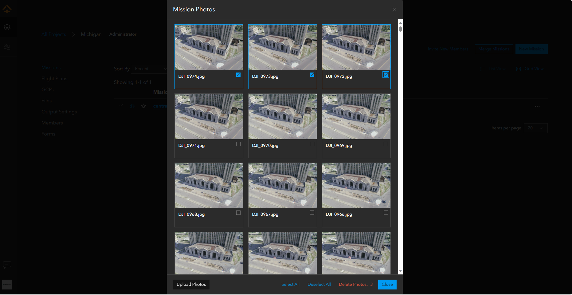

Hi,dont disagree this may be be improved, but You are aware the functionality offered through Mission > View Photos?
Which will give
Currently, images must be selected and deleted one at a time, which becomes time‑consuming and inefficient when working with large image sets. Adding the ability to select multiple images and delete them in a single action (such as through checkboxes or multi‑select functionality) would greatly improve workflow efficiency, particularly during data cleanup and quality control tasks.
