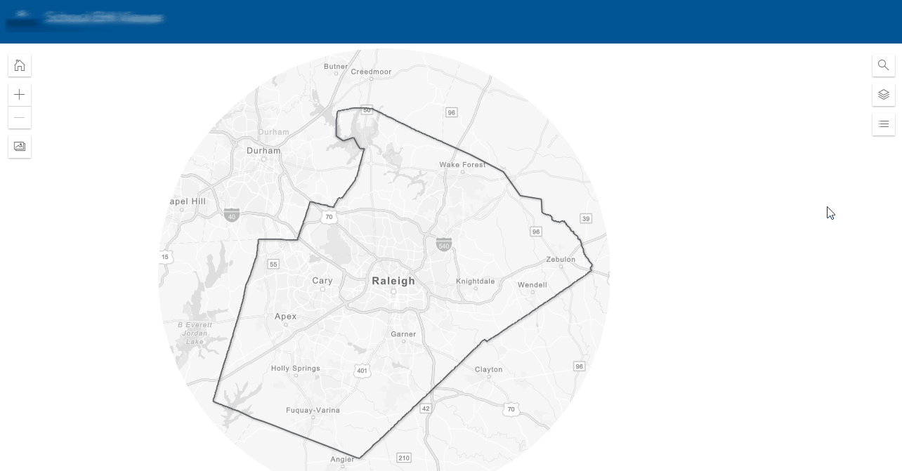

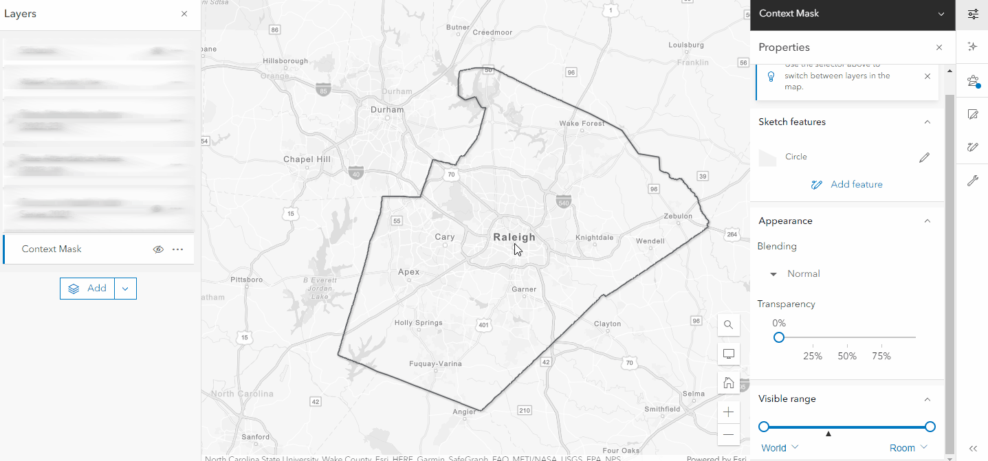

There are cases where it would be helpful to have a layer as a part of the map that is both excluded from the legend and a layer list in derivative applications. The blend modes functionality provides a useful example. Say I create a Sketch layer and draw a circle around an area of interest. I can use blend modes on the Sketch layer to mask, for example, the basemap so only the area in the circle is visible (See animation below).
In this case, for derivative applications, I would not want users to be able to toggle the Context Mask layer off. However, when I use this map in the Basic Instant App, Context Mask is among the togglable layers in exposed by the LayerList widget.
