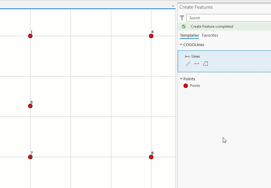

You can see that:
1. The entered COGO dimensions are preserved
2. While the line fell short it updated the end vertex to the point.

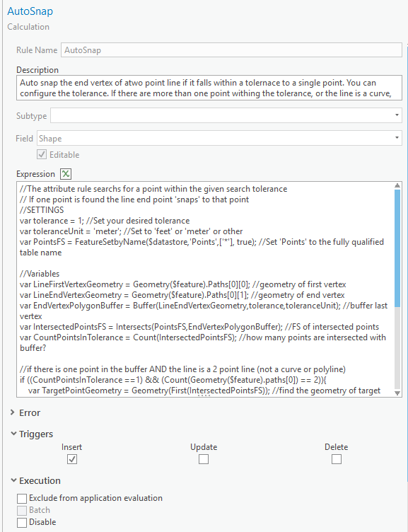

How this is implemented?
When creating a new line (Insert trigger event), the end vertex of the line is extracted and buffered with the specified tolerance.
That buffer is then intersected with the points.
The number of intersected points are counted - if there is exactly one point that intersects the buffer the geometry of the line ($feature) is updated.
This attribute rule returns a geometry ('Polyline' method) that is calculated directly into the shape field.
Here is the expression:
//The attribute rule searchs for a point within the given search tolerance
// If one point is found the line end point 'snaps' to that point
//SETTINGS
var tolerance = 1; //Set your desired tolerance
var toleranceUnit = 'meter'; //Set to 'feet' or 'meter' or other
var PointsFS = FeatureSetbyName($datastore,'Points',['*'], true); //Set 'Points' to the fully qualified table name
//Variables
var LineFirstVertexGeometry = Geometry($feature).Paths[0][0]; //geometry of first vertex
var LineEndVertexGeometry = Geometry($feature).Paths[0][1]; //geometry of end vertex
var EndVertexPolygonBuffer = Buffer(LineEndVertexGeometry,tolerance,toleranceUnit); //buffer last vertex
var IntersectedPointsFS = Intersects(PointsFS,EndVertexPolygonBuffer); //FS of intersected points
var CountPointsInTolerance = Count(IntersectedPointsFS); //how many points are intersected with buffer?
//if there is one point in the buffer AND the line is a 2 point line (not a curve or polyline)
if ((CountPointsInTolerance ==1) && (Count(Geometry($feature).paths[0]) == 2)){
var TargetPointGeometry = Geometry(First(IntersectedPointsFS)); //find the geometry of target point
var x1 = TEXT(LineFirstVertexGeometry.x); //start X coordinate
var y1 = TEXT(LineFirstVertexGeometry.y); //start Y coordinate
var x2 = TEXT(TargetPointGeometry.x); //target X coordinate
var y2 = TEXT(TargetPointGeometry.y); //target Y coordinate
var SR = Geometry($feature).spatialReference; //spatial reference of the line
var polylineJSON = { //create a JSON representation of the updated line
"hasZ":true,
"paths":[[[x1,y1],[x2,y2]]],
"spatialReference":SR
return Polyline(polylineJSON); //return the Polyline to update the SHP field
Attribute rule setting:
