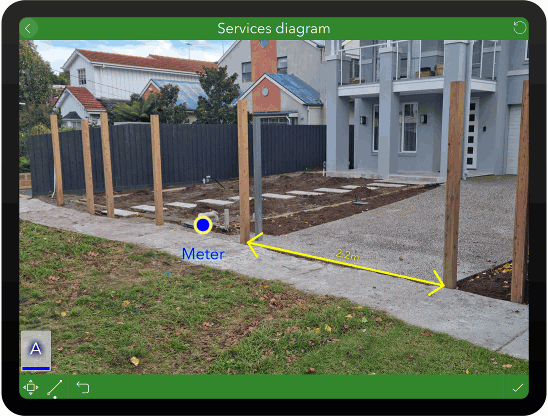

Draw and annotate are staple features of Survey123. By applying the annotate appearance to an image question, an author can allow users to mark up a photo captured with the device’s camera, an existing image file, or a snapshot of a map. Similarly, an image question with the draw appearance provides a blank canvas for users to sketch on.
Draw and annotate questions are useful in a range of applications. For example, an asset inspection field crew might take photos of equipment and mark-up any faults with the drawing tools. A law enforcement officer might take a snapshot of a map and then sketch a diagram of where an incident took place.

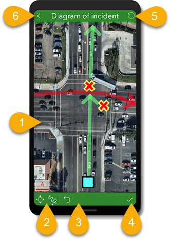

The September 2021 release brings with it several improvements to the user interface (or canvas interface, as we like to call it). The canvas interface is documented here. The canvas can be in one of two modes: explore or draw. Here’s a quick tour:
- Canvas—Images and graphic elements are added to the canvas.
- Explore and draw modes—Switch between the two modes.
- Toolbar—Buttons for various options will appear here. Buttons vary depending on the mode the canvas is in and the active drawing tool.
- Save image—Save the image and return to the survey form.
- Reset—Reset the canvas by taking a new photo with the camera, selecting a new image from file, taking a snapshot of a map, or reverting to a blank canvas. Note: All graphic elements and images currently in the canvas will be removed.
- Return to survey without saving.

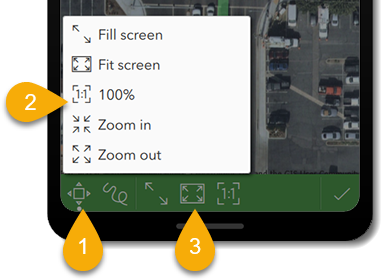

In explore mode you can zoom and pan the canvas; zoom to the actual size (100%) of the canvas; adjust the zoom to fit the canvas on screen; or fill the screen with the canvas. Manipulate the view either by selecting the buttons or directly on the canvas itself using touch or mouse (on desktop).
Select the explore mode button (1) to enable explore mode. Select again to reveal the explore options menu (2). Several of these options are also available as buttons on the toolbar (3).

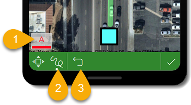

In draw mode, select the drawing tool preview in the bottom left of the canvas or the draw mode button to open the drawing tools palette. The drawing tools palette has been enhanced to include more drawing tools (including marker symbols and vertex-by-vertex lines) and greater control over color, line style, transparency, fill, and text style.
- Drawing tool settings preview—Shows a preview of the style settings for the currently selected drawing tool.
- Draw mode—Select to enable draw mode. Note that the icon for this button reflects the currently selected drawing tool.
- Undo—Undo the last graphic element. Buttons on the toolbar will change depending on the active drawing tool.

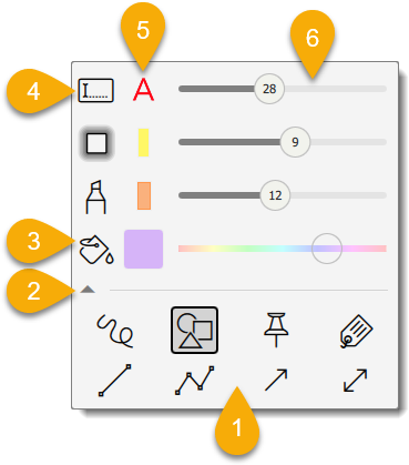

An overview of the drawing tools palette:
- Select from eight drawing tools.
- Expand or collapse the settings panel.
- Select the fill button (paint bucket) to switch off background fill (in the case of the label tool, the background can be disabled from the text options menu).
- Select the text button to reveal text options: single line, multiline, halo, and background color for labels. You can also turn off the label for a drawing tool.
- Select the color preview swatch to reveal the color palette.
- Adjust the text size, halo width, and line width using the sliders.
The drawing tools palette can be expanded or collapsed (2) and the state of the palette is remembered per question. When the palette is collapsed, switching to another drawing tool requires only a single selection, so once you’ve set up your drawing tools palette you can collapse it to make selecting tools faster:

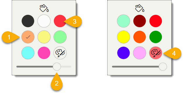

There are eight default colors to choose from, plus a ninth swatch for setting a custom color; however, any color swatch can be customized by pressing and holding it.
- Active color, indicated by check mark. If the custom color swatch is active, no check mark is shown.
- The slider lets you change the opacity in increments of 10% from 10 to 100%.
- Press and hold on any of the other eight colors to set a new color.
- Bottom right color swatch can be used to set an additional custom color.
Note (3) and (4) launch the default color picker dialog for your device’s OS.
The image below shows the default color palette on the left, and a customized palette on the right:

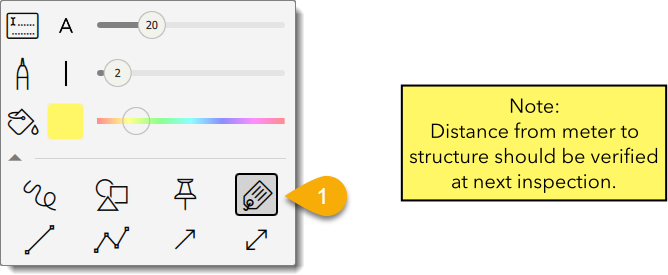

Each drawing tool has text enabled by default. The position of the text varies depending on the drawing tool. For example, for straight lines the text is positioned above the midpoint of the line and rotated to the same angle as the line itself (perfect for adding dimensions!). For shapes, text is positioned in the horizontal and vertical center of the polygon, and for markers the label is placed underneath the symbol itself. To disable text for a drawing tool, select the No label option from the text menu.
You can also add a text label on its own using the label tool (1). This allows you to create “sticky note” labels (see an example, below) with background fill and outline that can be positioned wherever you like on your image.

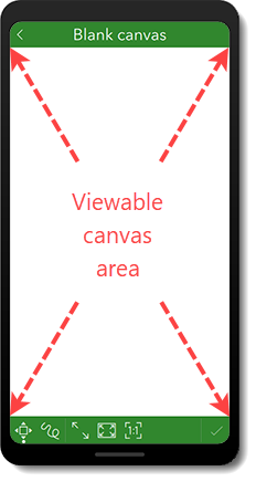

Before we get into the details about image size, let’s define the term "viewable canvas area". The viewable canvas area is the region in the app between the title bar and the toolbar, where the canvas or image is presented and you can add graphic elements (lines, text, symbols, and so on). The size and resolution of the viewable canvas area is dependent on the device’s screen dimensions, and the size of the application window when running the field app on desktop.
Prior to the September 2021 release, the image size for draw and annotate questions was limited to the dimensions of the viewable canvas area. Photos taken with the camera or added from file would be resized to fit the viewable canvas area. When adding an image to the canvas, users were often seeing their annotated images reduced to a much smaller size than their original image, which is not ideal if you need to do detailed annotation work. With the latest release, you can configure your survey so that the original size of your source images is preserved.

- Blank canvas—If max-pixels in not specified and there is no default image, the canvas for a draw question will be set to the dimensions of the viewable canvas area.

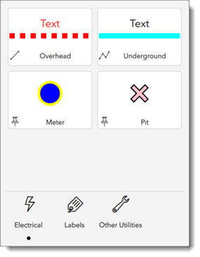

The Survey123 field app ships with the default drawing tools palette containing eight tools that users can configure in the app. We’ve received requests from organizations that wish to standardize the drawing tools so that annotated images are consistent across surveys and across their organization.
The Survey123 team is working on a method to allow survey authors to design custom drawing tools palettes and set these on a per-question basis. For example, a utilities company might have specific symbols and line styles that relate to electrical or gas works. Custom palettes can help make image annotation in the field more efficient and consistent.
