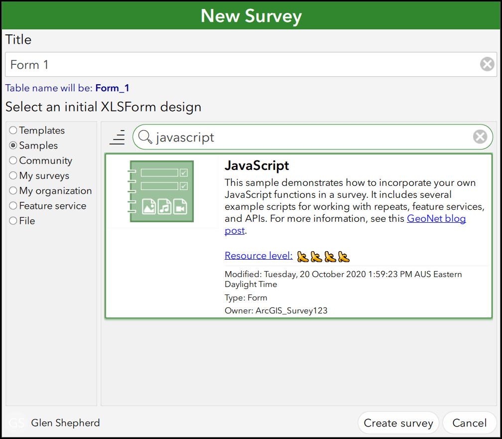

Create a new survey from file, using the "OutOfBounds.xlsx" form mentioned above.

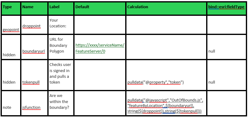

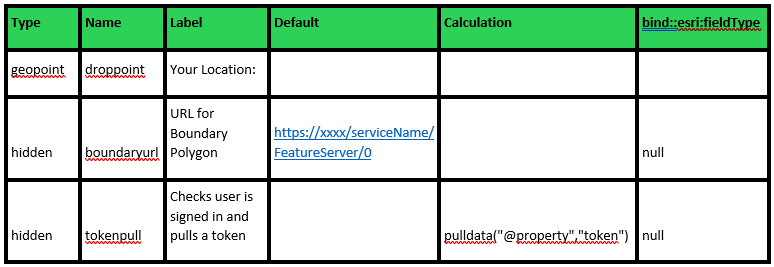

We'll start by adding a "geopoint" question to our survey.
Then, add a "hidden" question and place the service URL of your polygon feature layer in the Default column.
Furthermore, if our feature service is secured (i.e. not public), we will want to include another "hidden" question to incorporate the pulldata("@property","token") function and provide a token which our JavaScript function will require to access the service:

In a 'note' question, we add the following function to the calculation field:
pulldata("@javascript","OutOfBounds.js","featureByLocation",${boundaryurl},string(${droppoint}),string(${tokenpull}))
- "@javascript" - looks for .js files in the scripts folder
- "OutOfBounds.js" - specifies the name of which .js file to pull
- "featureByLocation" - specifies which function to use from the script (there's only one in this example)
- We then populate the parameters of the function (specified in Line 7 of the attached script):
- ${boundaryurl} - our hidden question containing the layer URL
- string(${droppoint}) - stringified geopoint question providing user location
- string(${tokenpull}) - stringified hidden question providing the feature service token
Now, once the mobile device has captured a location for the geopoint question, the JavaScript function will return either "Within Boundary" or "Out of Bounds" depending whether the user's location is intersecting a feature in the feature service.

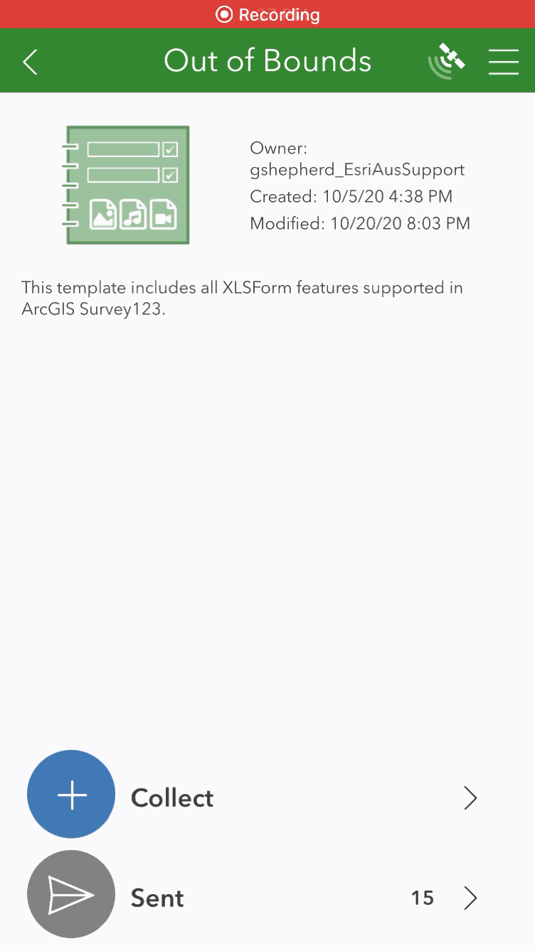

The result for the end-user in the Survey123 mobile application may look similar to the following:
