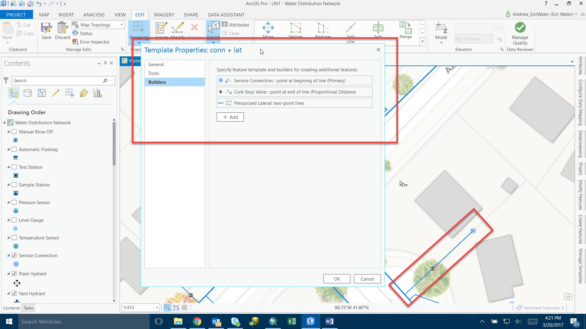

Using the below Group Template with Builders in ArcGIS Pro I am close to what i want, however:
- This requires the user to draw a line, connecting the end to the water main. I need the lateral to be auto-created simply from dropping a point.
- The curb stop gets placed correctly, however it fails to split the single lateral line into two - how is that achieved?
