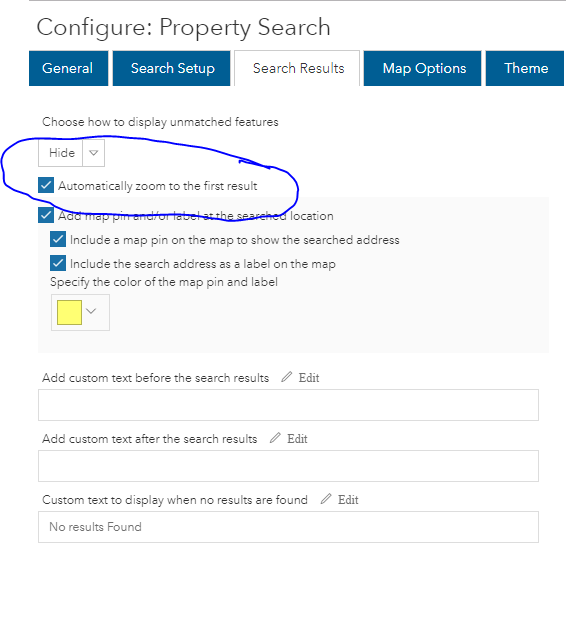

As of now when you search an address in the Zone Lookup tool you can't control the zoom level. There's a button to zoom you out to the feature (zone). It would be nice if you zoom down to the property since that's what you're searching. The property searched should be the focus not the entire zone.

It's currently zooming out to the large zone. It would be nice if you could have it zoom to an address and edit the zoom level.
I use Arcade FeatureSets on copies of the property layer to avoid that behavior
Where do you put that expression? We're searching off a locator.
You would create it as an Arcade expression in the layer of the web map. So if you want the search to be at the property level, you would have multiple copies of your property layer with different FeatureSet queries using Intersects. Of course, you can rename the copies of the Property layer, so you can distinguish which layer returns what info.

I may have my map set up differently. I have each district as a separate feature layer. There isn't a single property layer with each district in the table.
