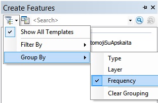

Would be useful feature in ArcGIS Pro to organize Create Features templates by user needs. At the moment there is no functionality to filter templates by usage frequency (like it is in ArcMap).It would be nice feature to let user rank templates by priority. And to have possibility to order templates by rank. So user can build his custom list of most used or required feature templates. Then group templates by rank or frequecy.
Favorite Feature Templates were added to ArcGIS Pro at version 2.4 which allows you to organize templates by dragging and dropping them or putting them into folders:
https://pro.arcgis.com/en/pro-app/2.6/help/editing/organize-favorite-feature-templates.htm
