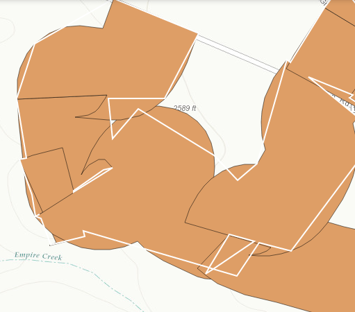

I am working with geometryservice's union. I noticed while testing it that depending of the scale you are at the "union" does not return high quality graphs. Is there something I need to modify in my union to make it more accurate or should I just use a geoprocessing service?
Alex,
it looks like the geometry for the FeatureLayer is being generalized. You should use the:
yourFeatureLayer<SPAN class="punctuation token">.</SPAN><SPAN class="token function">setMaxAllowableOffset</SPAN><SPAN class="punctuation token">(</SPAN><SPAN class="number token">0</SPAN><SPAN class="punctuation token">)</SPAN><SPAN class="punctuation token">;</SPAN> yourFeatureLayer<SPAN class="punctuation token">.</SPAN><SPAN class="token function">setAutoGeneralize</SPAN><SPAN class="punctuation token">(</SPAN><SPAN class="keyword token">false</SPAN><SPAN class="punctuation token">)</SPAN><SPAN class="punctuation token">;</SPAN><SPAN class="line-numbers-rows"><SPAN></SPAN><SPAN></SPAN></SPAN>
