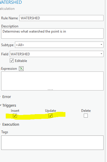

If I want the field calculated on insert or edit, I do this:
Problem is, what if the user makes an attribute edit, not a shape edit? The rule still fires (and takes a performance hit).
With SQL triggers, I can restrict them to only fire if the shape is new or updated, and ignore any attribute updates.
The same functionality should exist for attribute rules.
