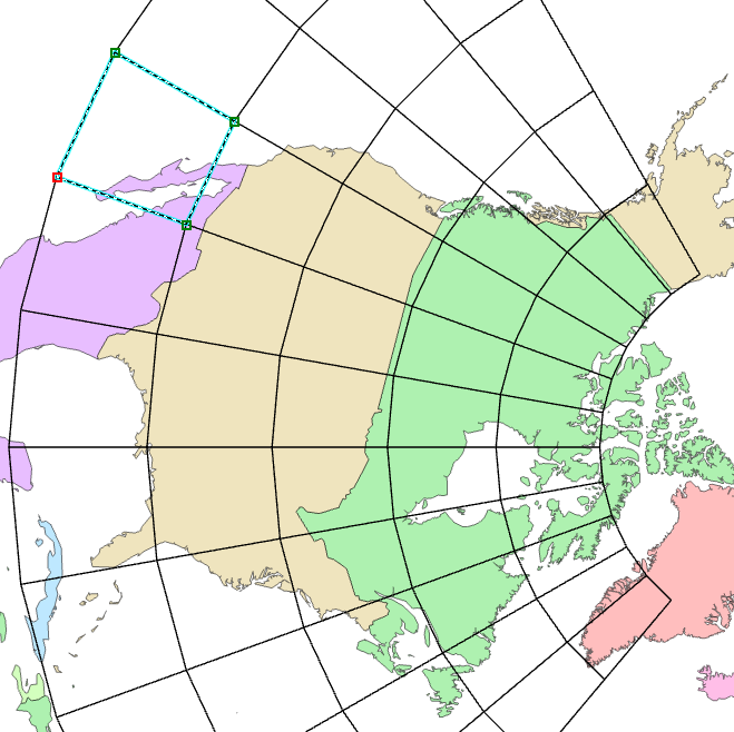

As an example I have created a 10 degree x 10 degree grid for North America and then changed the map spatial reference to North Polar Stereographic. Because the grid doesn't have any intermediate vertices the feature class appears blocky. Using a resolution of say 0.1 degrees would introduce vertices within each feature so as to make it smoother.

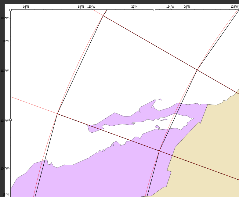

I think the logic to do this already exists in the Layout Grid function. If I go to my Layout and add a Grid and color it red you can see the difference.
