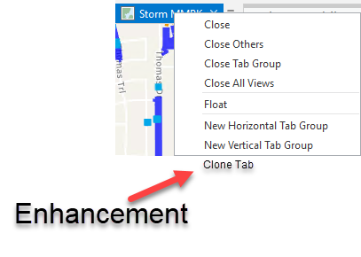

The ability to clone map tabs so you can keep configuration. This is helpful when publishing several MMPKs with offline basemaps that are identical. Makes it way more efficient to configure and publish many maps (MMPKs) without needing to reset map settings. arcgispro
Thank you for submitting this idea Luke Savage Does opening the same map not achieve what you're looking for?
Or specifically you're looking for that from the tab's context menu?
Thanks!
Yes Kory it is but is an awkward place to perform that function. The UI for right click on the map tab is managing that tab. Plus, it's more cohesive and logical for the user if in the tab management UI. If the catalog pane is not open, you can't add it within the tab experience.
Thanks for the clarification, Luke! This also helps to understand that a copy of the map isn't needed, just a second view pointing to the same map.
Cheers
Please save us time and a few clicks by adding a duplicate map / layout when you click on a tab in ArcGIS Pro. Right click - Duplicate - Done. Instead of finding the map in the table of contents, right clicking to copy, right clicking to paste...
