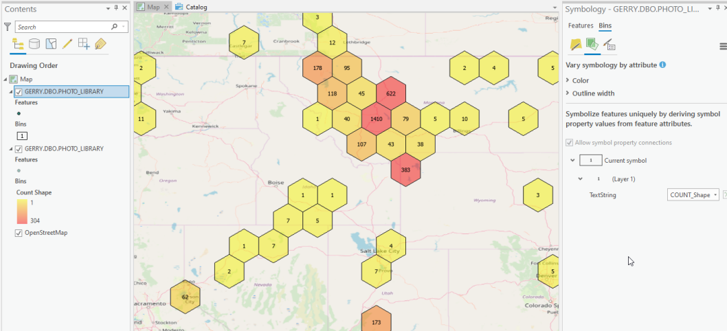

Thank you. This does work for me. There is however, nothing intuitive about finding this setting. I will always have to follow the instructions to be able to do it. I don't understand what "Template" means in the Primary Symbology Tab, and I don't understand why a symbol layer called "Shape Marker" would be the thing to provide a text label. It isn't obvious at all that the "Text String" option allows the text string to be based on the feature count. If I hover over the database icon, I see that $feature_COUNT_Shape is the "Property mapped to expression", but if I click on it, the only option in the drop-down list is <None>.
If I go back and select something from the drop-down list on the "Form" line, every bin now gets marked with the same symbol, and I don't know how to get back to where there is a "Shape text symbol" option with a Text string field. I have to remove the layer from the map and add it back in again.
