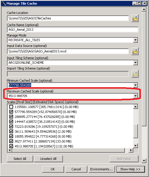

- Manage Tile Cache). We chose to only generate tiles to a maximum cached scale of 4513.988705 to keep the tile cache relatively small in size.

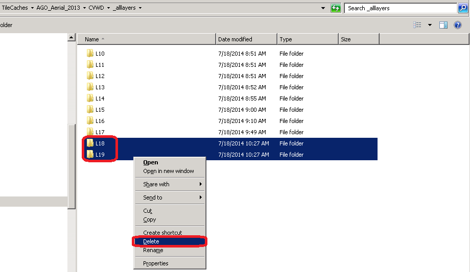

- Once the tile cache is done generating, navigate to the tile cache using Windows Explorer. Drill down into the "_alllayers" folder within your tile cache folder ( i.e. [Tile Cahce Name] --> [Data Frame Name] --> _alllayers). You will notice that there are folders present for each level. In our case, we did not generate any tiles for levels past Level 17 (1:4,513) so as a result, the "L18" and "L19" folders are empty. Select those 2 folders and delete them.

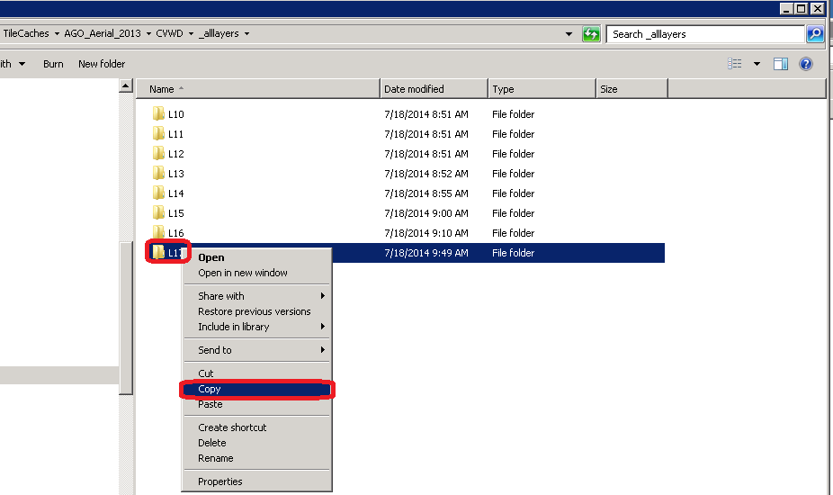

- Next, copy the "L17" folder twice within the "_alllayers" directory, and rename the two copies "L18" and "L19" respectively.

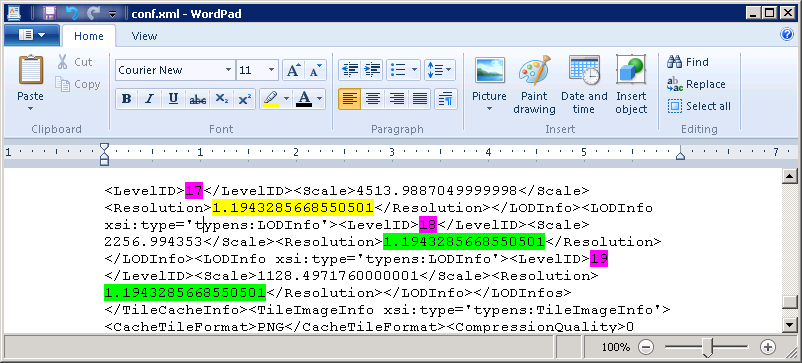

- Next, navigate up one directory to where the tile cache configuration files are stored (i.e [Tile Cache Name --> [Data Frame Name]). The first file to modify is the "conf.xml" file. In this file, find the resolution for the tiles that were generated for level 17 (highlighted in yellow) and copy that resolution (i.e. replace the existing resolution) for levels 18 and 19 (highlighted in green). Save the file.

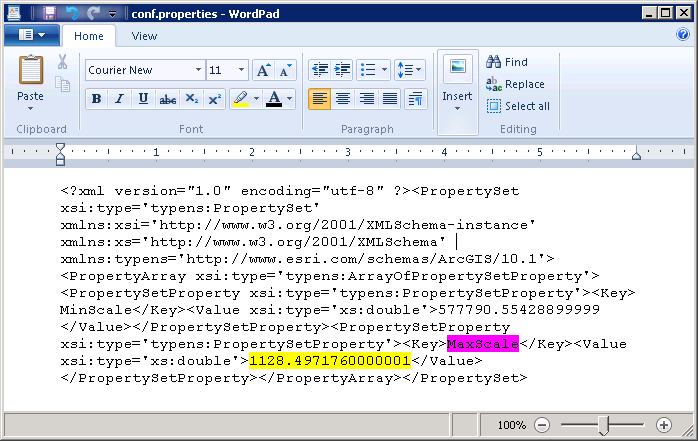

- Finally, modify the "conf.properties" file and replace the "MaxScale" value with the 1128.4971760000001 (highlighted in yellow), which is the scale for Level 19. Save the file.

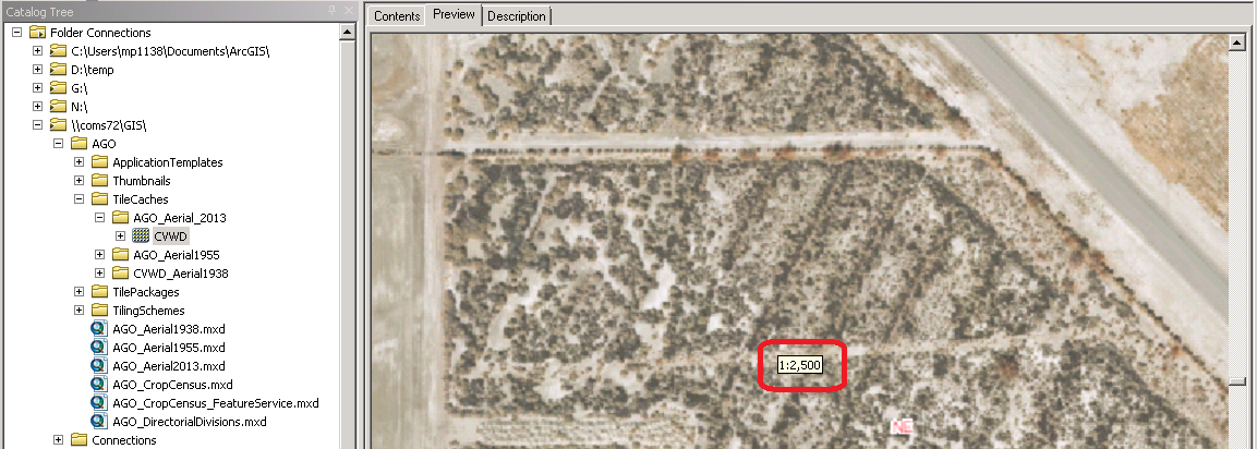

Once those steps were completed, we reviewed the Tile Cache in ArcCatalog and we can now see that the imagery stays visible at all scale levels. obviously as mentioned, the resolution does not get any better past 1:4,513, but at least the imagery does not disappear for our users when zoomed in past that scale.
