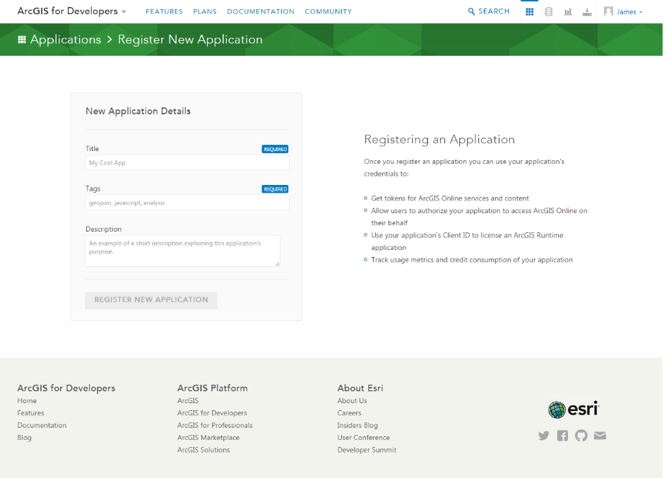

In order to authenticate our request for credit consuming services (routing, geoenrichment, etc) we need to register for a developer account, and register a new application. You can register for a developer account at http://developers.arcgis.com .

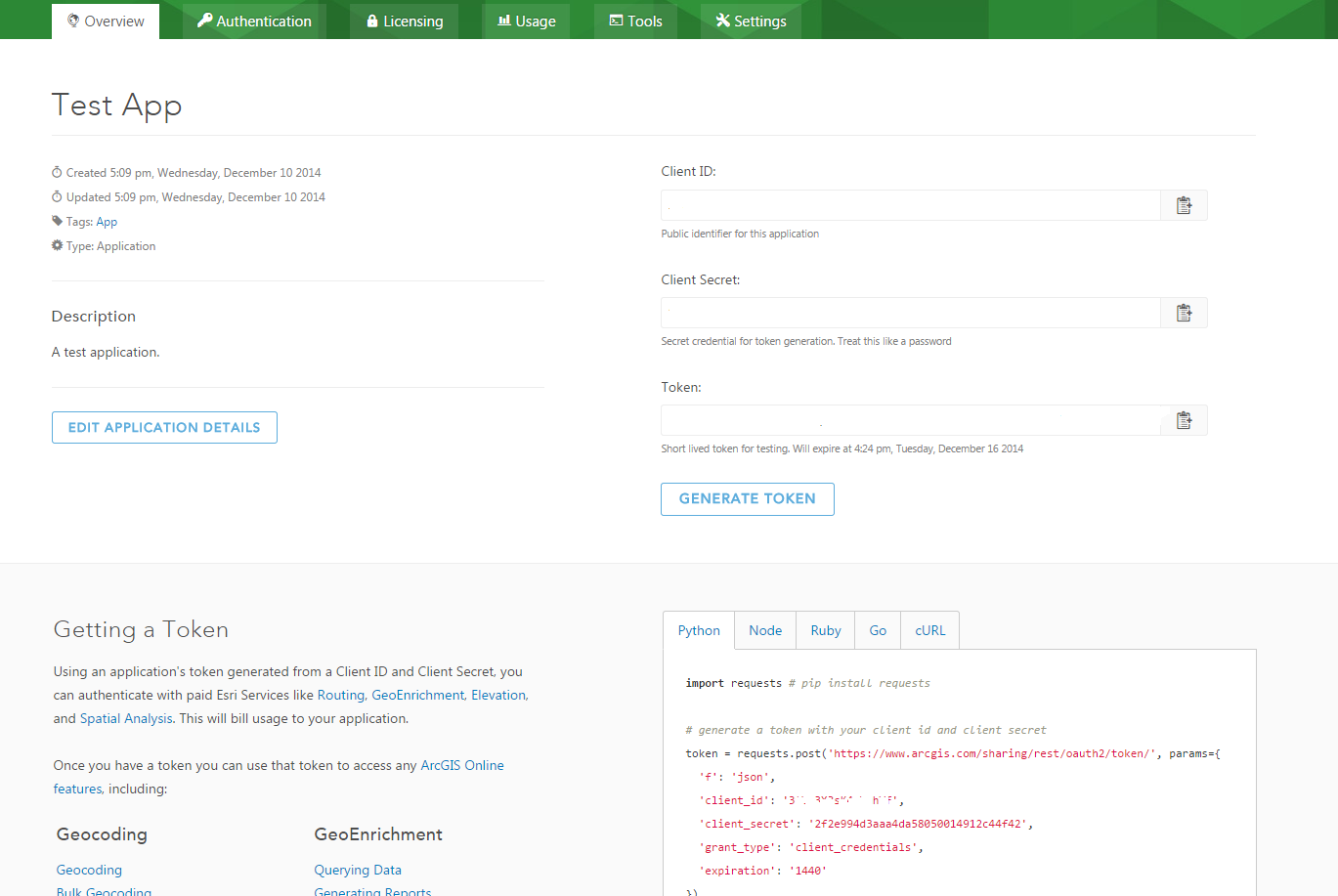

Once you have registered your free developer account, you can create a set of application credentials from your control panel, by clicking the applications tab.
When you do this you will receive a Client ID and a Client Secret (also a Token however this will expire). We can also get some nicely auto generated code for server side REST requests using Python, Node.js, Ruby, Go, cURL. You may also be interested in the ‘Usage’ tab that gives you a dashboard about credit usage.
