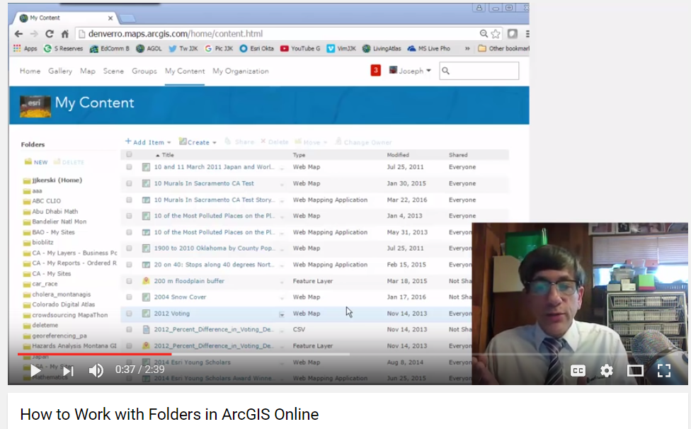

1. Use folders. As I explain
in this video, using folders is an excellent way for you to keep your projects organized in ArcGIS Online. Don't place everything in the "root" folder. Make it a habit to store the results of your analysis, which are stored as map layers, in a folder that you have created for one single project. Periodically go through your folders and delete maps, services, and layers that you no longer need. Along these lines, be a good digital citizen and clean up after yourself, by unsharing anything that does not need to be shared, with the general public, and organization, or a group.
