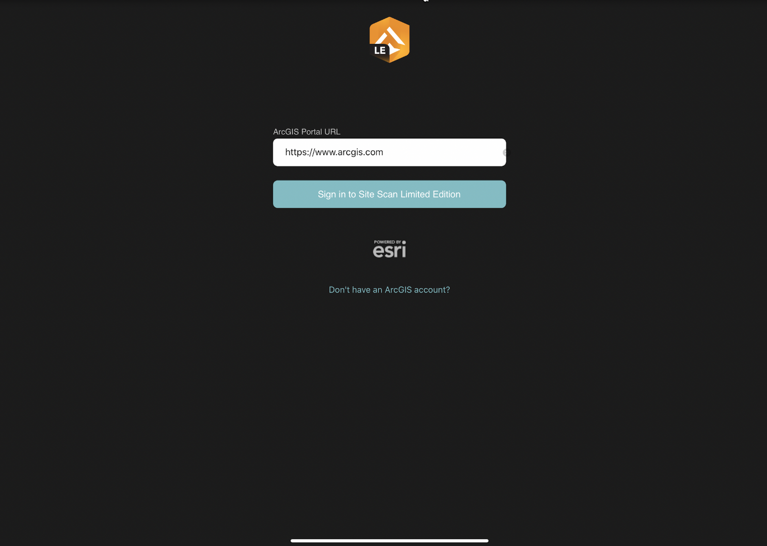

- Accept the default option of https://www.arcgis.com as the portal URL
- Tap the Sign in to Site Scan Limited Edition and Enter your ArcGIS username and password

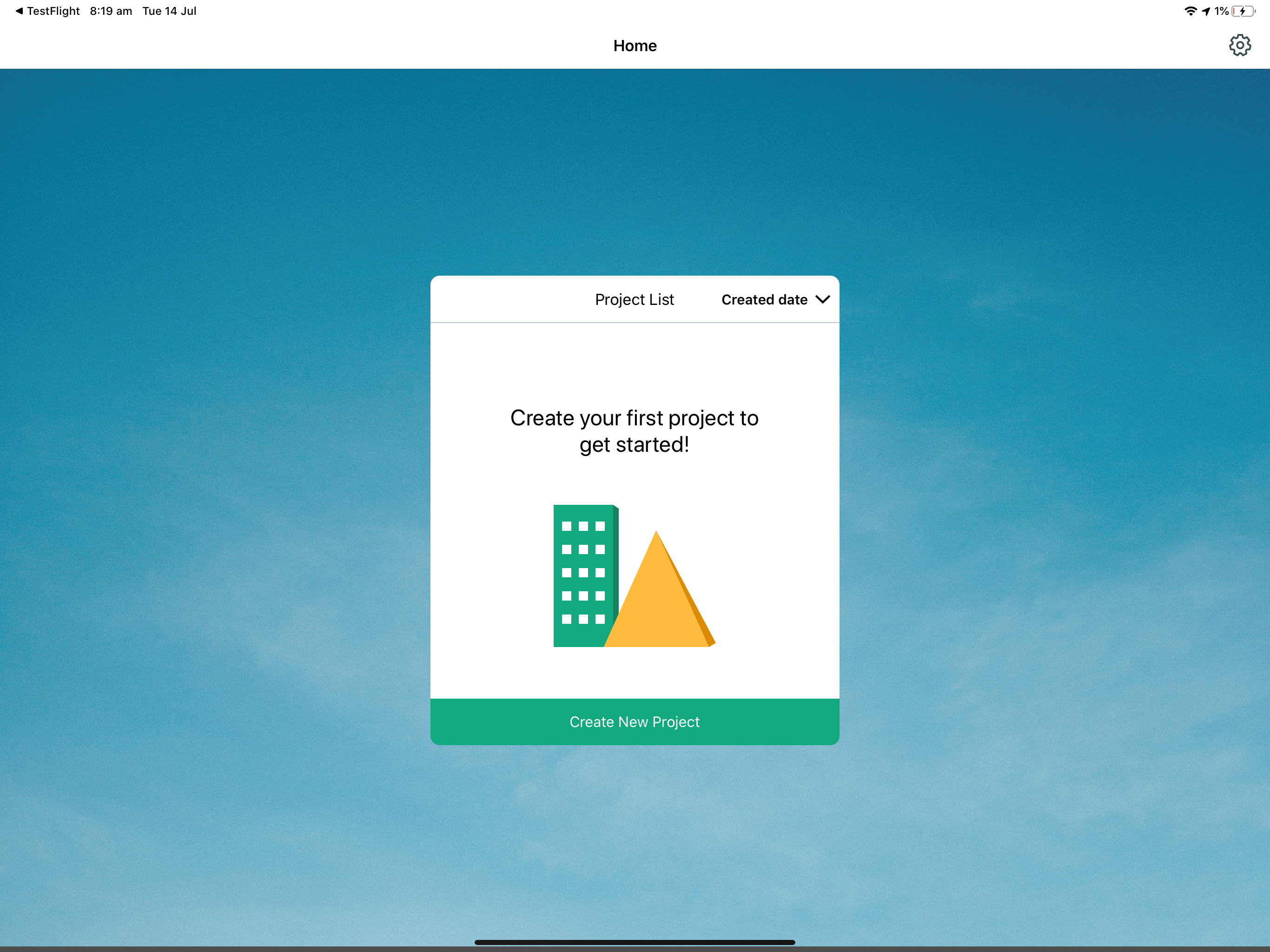

- Click next (and accept all the permissions requests) until you reach the Create New Project page
- Tap the option to Create New Project and give the project a name, and tap Save Project

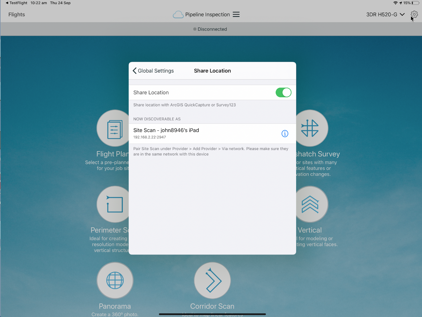

- Go back and tap Share Location and then enable Share Location
- Take a note of the Location Provider Hostname and Port (e.g.192.168.2.22:2947) and close settings.

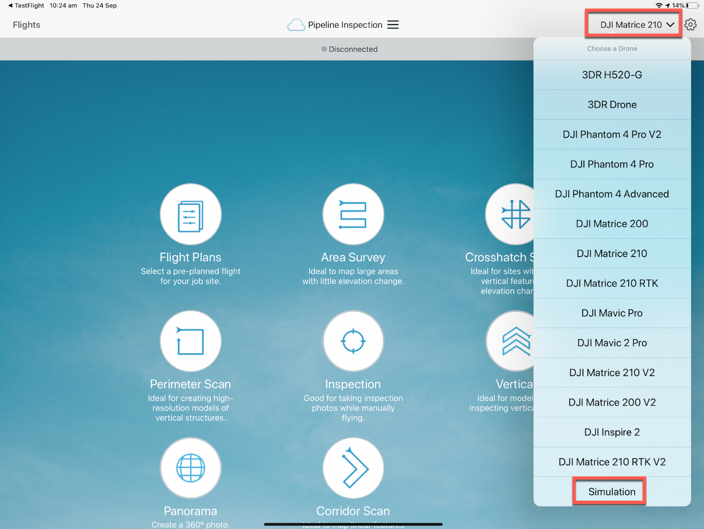

- Select your drone in the dropdown, or select Simulation

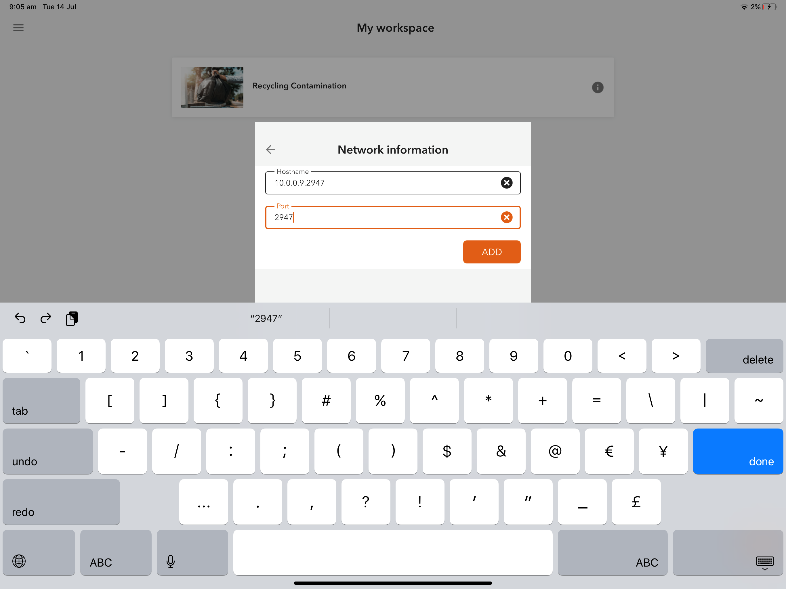

- Tap Provider and then choose ADD Provider Via Network
- Enter the Hostname and Port taken from Site Scan and tap ADD - QuickCapture should now receive location updates from Site Scan
