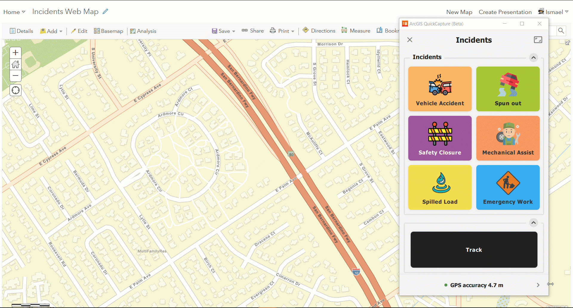

Lets start with a simple example to warm up: A new record is submitted from the QuickCapture mobile app and the closest address to that location is automatically found and stored as a GIS attribute. Something like this:

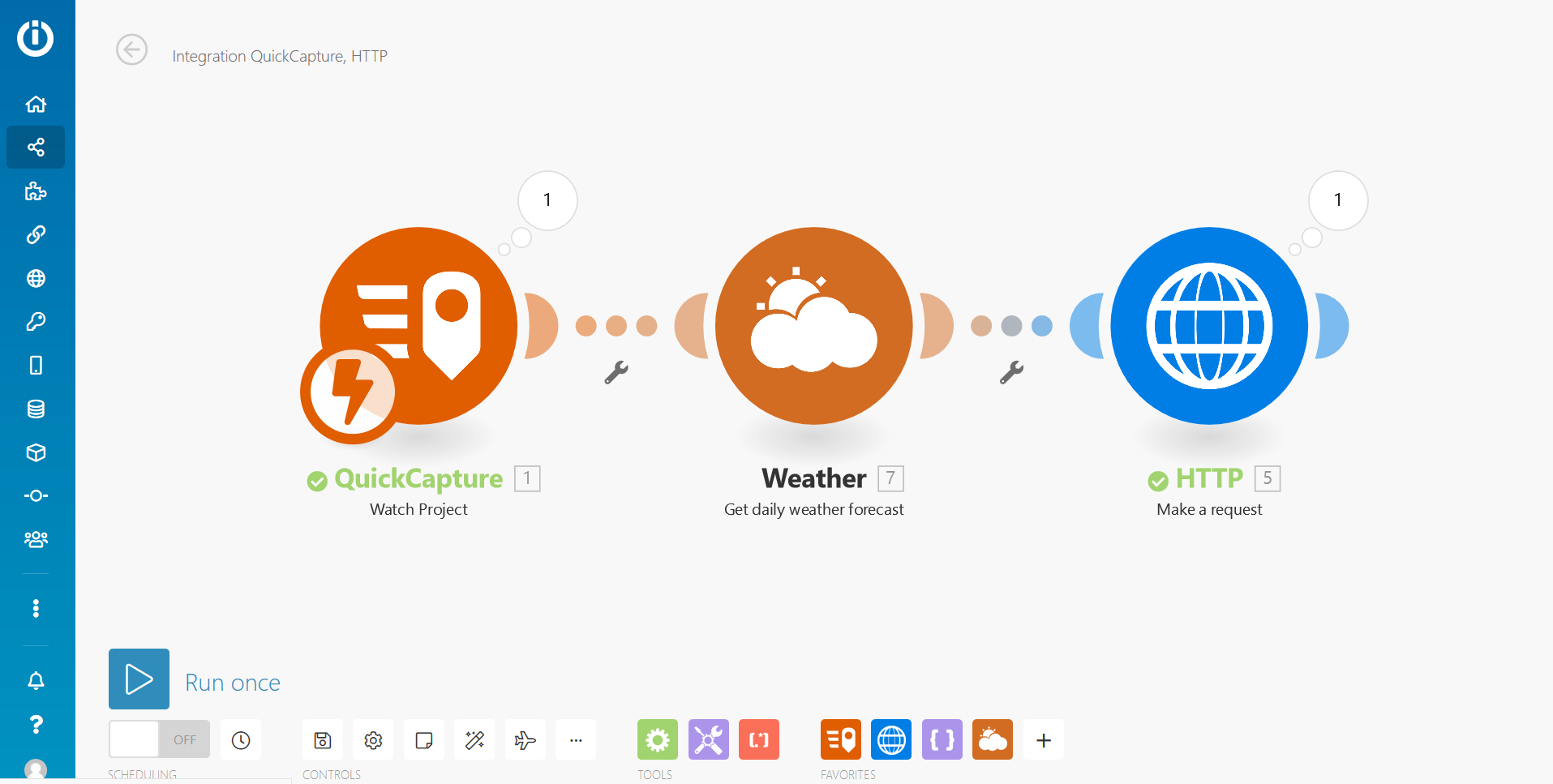

Using the Integromat Weather app, you can also enrich incoming QuickCapture records with a weather forecast. The Weather app takes an an input the XY coordinates of the location you are interested in and can report a weather forecast for the following day or days.

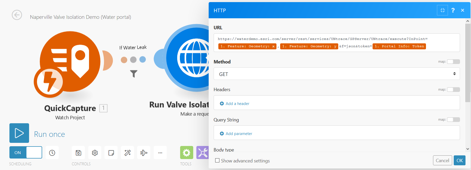

If you are into ArcGIS geoprocessing services, you can also use the HTTP module in Integromat to pass parameters and run your own gp services. The great thing about gp services is that they provide great flexibility to do more sophisticated analysis on the QuickCapture record location. In the screenshot below, for example, the HTTP module invokes a service that runs a valve isolation trace against a Utility Network dataset. The output, again, is used to enrich a QuickCapture observation.
When working with Geoprocessing services in this way, it is important to execute the tasks synchronously. The ouptuts from a gp service are processed similarly to how outputs are parsed from the Esri Geocoding service.
